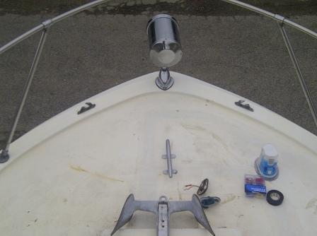

]Nice job Matt , was one of first things I had done but just half forward deck and half mid deck. cpl years sitting rest of decks tthat wasn't done got worse so have to do those eventually. Very top cover is totally soaked according to moisture meter will need to replace it or maybe even try going with out it . not sure yet
forward deck
forward deck
Looks like are boats are very similar but they call mine f 25 lol
