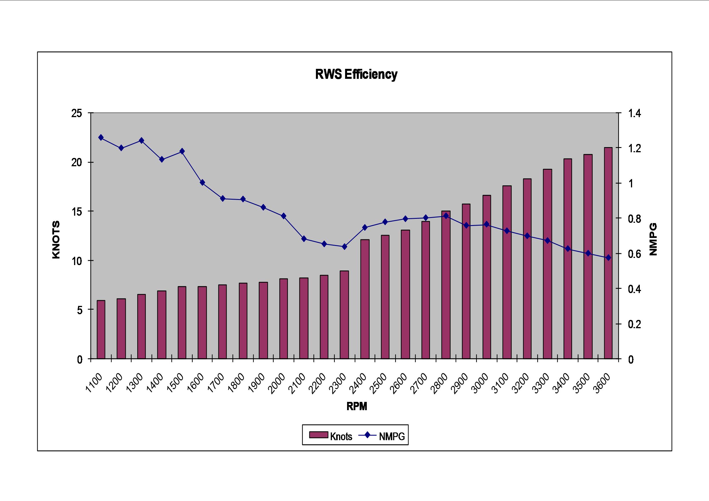

here is my often posted fuel efficiency table for my 10 meter express (not mid cabin) 454 Crusaders - quadrajets - 4 blade props - larger trim tabs w/drop fins.
Done in 2003, prior to the diesel repower.
CRUSADER 454 GAS ENGINES

RWS, Thanks for including the gas efficiency table.
If I'm reading the table correctly and I'm definitely not sure if I am, it would appear that 2800 rpm is a good spot to run at, if up on plane. Please tell me if I'm reading the figures correctly.
During the past week-end, I took my '94 up to 3000 and ran along for a while. As i did, I eased the tabs down and watched the bow pulpit drop till it felt like an optimum position. The lake was fairly busy and I slowed a couple of times for some small craft.
Then I ran at 2800 for a mile or so, at which point I noticed 19 mph on the chart plotter, which I believe is pretty close to the figures in your table. The boat felt pretty good at this speed.
I plan to run at 3500 sometime later this week, whenever I have time to go back to the marina.
I've got the stock tabs now, of course, but I plan on checking out drop fins as an upgrade.
Right now though, it sort of looks like I'm going to be around 1500 for the best fuel economy and 2800 for cruising speed when overall time is not really an issue.
Thanks to all for the comments and ideas. Much appreciated.

you are reading the chart correctly.
of course, that chart is for a different vessel
select a throttle/rpm position.
adjust the tabs while watching the GPS ground speed
then dial in the tabs for the best speed at that RPM
different conditions will provide varying results as load, fuel weight, wind, tides, current and chop will all combine to create variables for the running conditions
ALWAYS watch the GPS for speed when adjusting the tabs
