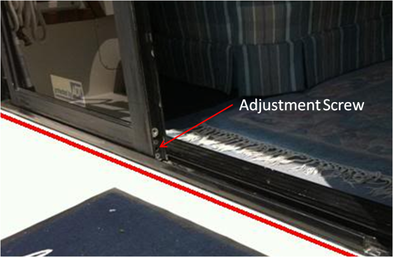

I zoomed in on one of my old pics and tried to show how you get to the adjustment screws. The screw is recessed about 2-3" inside this hole (phillips head screwdriver required, I believe), and there is another hole on the other end of the
door for the trailing edge.
- Doorrolleradjustmentscrew_zpsb11100fb.png (706.98 KiB) Viewed 2574 times
As far as problems lifting the
door off - the rollers are spring loaded. After pulling the L-angle off, you may have to lift the
door and wedge a short piece of 1x2 under it, then get down on your hands and knees with screwdriver to try to 'lift' the rollers clear of the track. Helps to have a second set of hands for this - one person handling the
door, the other lifting the rollers clear.
