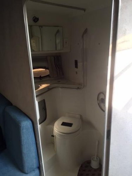

On the 10 meter express is it possible to replace it with a standard marine toilet system? Has anyone done that. If so would appreciate information. Thanks

Is your head built in ? If not it would be easy , if it is it would take some work to say the least .
Re: Vacu-flush system replacement??
Posted: Sat Nov 17, 2018 5:23 pm
by fighterpilot
I think this would be considered built in. Right?
Posted: Sat Nov 17, 2018 6:48 pm
Yes
Posted: Sat Nov 17, 2018 8:44 pm
by fighterpilot
With the vacu flush was some water pumped into the toilet basin, as the vacu flush was turned on. If so maybe vacu-flush could be bypassed and the drain hose go directly into the holding tank. Toilet is higher than holding tank. Assume pump out hose comes out of the holding tank so could still have it pumped out. Does the macerator pump pull directly from the holding tank? If so could still pump overboard when permitted, assuming that combination would work. It is my understanding the macerator and the vacu-system are on separate lines. Thanks

As for ditching the vacuflush and going with gravity......note that the exit of my vacuflush toilet has an orifice that is maybe an inch in diameter. If yours is the same, consider what things gravity will get down through that opening.
The heads were the worst thing about my boat when i purchased it. Sealand with integrated holding tank, which meant when solids went down, they displaced vapors upwards. Head use is odor free now. Well, mostly....

After reading all the posts that came up in RWS's link I will see if I can find a workaround to the vacu-system. Toilet will get used very little. That system with duck bills, and $$ for parts etc, and the maintenance requirements, like flush some water, do this and do that, convince me we could get along very well with a porta-potty. So Will see if system can be changed to gravity type, even if I have to cut out the existing toilet. My son-in-law is pretty good with fiberglass work. Shower grate takes up a lot of space so could use that as well. Don't need the shower.
Will have to do some more "digging" to see if a gravity feed would function or not. If not porta potty it is. It is a fishing boat, not a live aboard or long cruises boat.

I don't mind carrying poop, if necessary. There are systems that work other than the vacu-flush. I will explore them and get something simpler, rather than spend hundreds to fix a system that may not last a year. The existing system is old, neglected and may be a constant money pit for me. Considering how little it will be used, even carrying poop won't be that bad if I can't work a replacement. It is 24 miles to get pumped out. On my last boat I put a y valve in and was able to use the wet/dry vac to pump out and take up to my septic tank at the house.
As to resale value-it is an old fishing boat. Not a cruiser or high dollar whatever. It was bought knowing the system didn't work. So if I get some sort of workable toilet I am ahead of the game. Anyway, The twin diesel Cummins do make it resaleable, regardless of the toilet.
