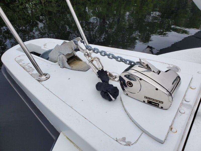

Good makes a great windlass. I am using a Lemar pro1000 on my F36

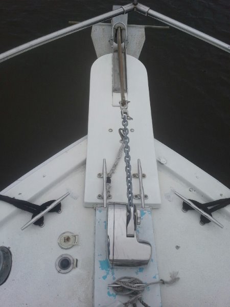

I sent my measurements to TOM RING at Good Windlass
we put together a great setup
beat the hell out of my old Lewmar freefall
We also moved the windlass aft a bit so the rode would dump into a deeper part of the anchor locker.
We modified the anchor locker door to accomplish this .
I have posted photos here on the Forum previously, suggest you do a search.

We use a Lewmar ProFish 1000

Hi Ron,
I own a 1994 Trojan 370 Express, one of those orphan Carver-assembled Trojan's after Carver bought the remains of the Trojan bankruptcy.
My boat has a Maxwell VWC windlass that works well. I'm replying essentially because of the similarity in our hull shapes.
I dealt with the American offices of Maxwell recently in order to obtain a replacement Clutch Nut Lever and experienced excellent communication and service. (When I originally bought the boat I had said, "What the hell's this thing old thing." .... and heaved the original lever into the garbage.)
Good luck with your purchase whatever you choose.
