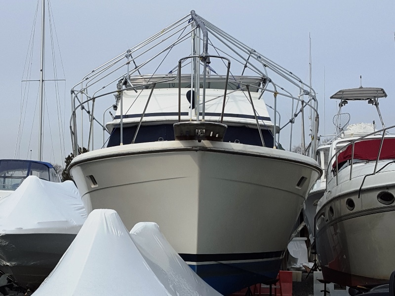

I appreciate all the help given and wanted to follow up with what I ended up doing.
The frame was built out of about 550' of 3/4" EMT conduit, using about 20 Kover Klamps, 10 Framemaker "T" clamps and 10 Framemaker 4-way clamps. The 4-way clamps were used to attach the ribs to the ridge pole and the "T" clamps to attach the vertical supports to the ridge pole. The Kover Klamps were used to attach the ribs to the bow rail and to anchor the ends of the stringers. The middle joints in the stringers were attached with 2 tie wraps and duct tape at each joint. Finally, we used pipe insulation along the ridge pole and some internal ropes to steady the frame.

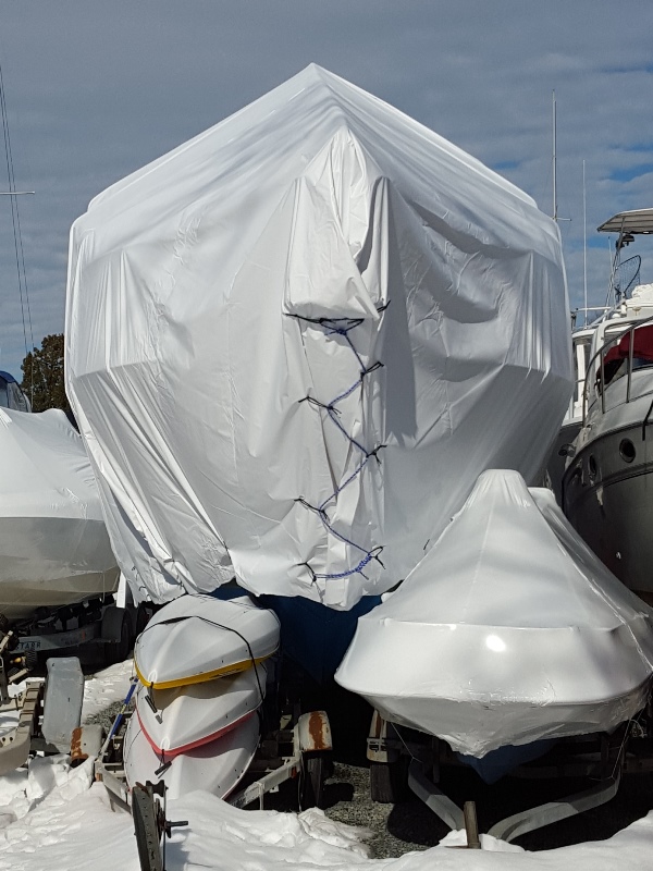

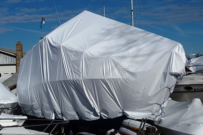

Posted: Thu Feb 04, 2016 6:21 pm
by WayWeGo
I ended up buying a 40' x 60' white nylon tarp from Billboard Tarps. The 40' width was perfect and I had considered going with only 50' long, but the difference in cost was not that great. The tarp weighed at least 125 lbs and was a real bear to get up onto the boat and spread over the frame. Once it was up there, the rest of the installation went smoothly and I cut off the excess material so it will be a bit lighter next time. The tarp was attached using cheap rope from Home Depot and Griff Clips fabric clips identical to Kover Klips but purchased off Ebay. The holes on the clips were too small for the rope I used, but I had 100' of marine shock cord which worked perfectly.

The whole job took two of us two half days and a third very full day, working from 10am to 11pm, with it snowing for the last five hours. Luckily the tarp was on top of the boat by the time the snow started, but I would not call it pleasant working conditions!
The real test of our design and construction was the snowstorm that blew through a couple of days later. The marina got at least two feet of snow and the nearest buoy on the bay recorded sustained winds of 40 knots and a gust of 70 knots. I was sweating bullets until we could get back to the boat a week later and see that it held up just fine to this storm.

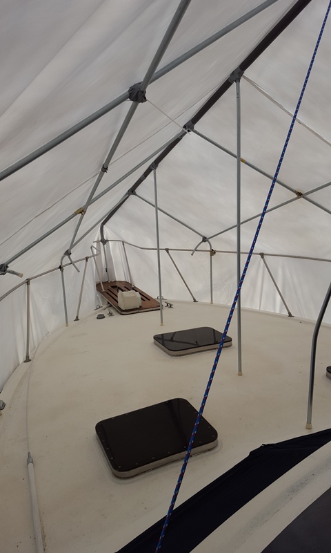

One thing I was not happy to see was that the tarp is not entirely waterproof. There are some seams where panels of fabric are joined, and you can see specks of daylight through these areas. The holes are pretty small (1/16" to 1/8" in a double or triple row), but it will certainly leak a bit of water in a heavy rain. In hindsight, I am now kind of happy to have them. One of my worries has been humidity under the tarp. When we visited the boat after the snow storm, it was bone dry under the tarp even though there was ice and snow on the boat when I covered it. Now I am much less worried about mold and mildew! To help with this, I did not cover the bottom of the swim platform and left the cover loose at the bow so air can flow through from front to rear.
When I bought the tarp, I had the option of choosing white on both sides or white on one side and black on the other. I chose the all white tarp so that it would be light inside, hoping to be able to work and hang out on the boat during the winter. That has worked out well for us.
