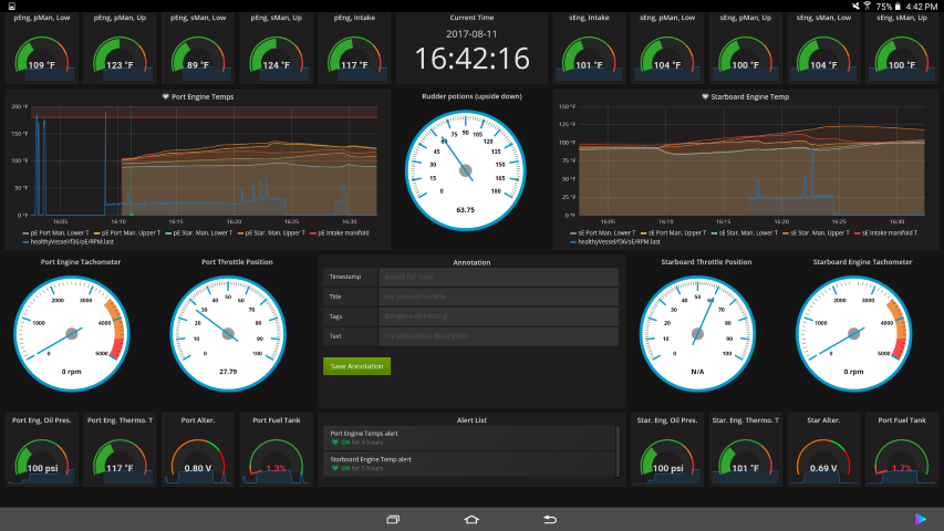

I got the RS11 working today along with the other temp sensors. I tried to take a video but got caught with another issue the reflection on the Samsung tablet did not play nice i will have to get an anti glare. Its not so bad when your using it but on my phone taking a pic or video its awful.
I have a attached a screen capture which is about 20 minutes int a start up and various dables with the throttle.
This is with out calibration: that is to say im simply setting the gauge conversion so that it takes 1-12V and converts this to 1-100 and 100-1 for the fuel.
I will have to tweak further but will need to run the boat as each gauge is a scale (other than voltage of course).
Also i solved the wireless performance. I printed new cases for both Engine and the base station PI''s allowing more holes and in the change other realized that the base station PI the wireless antenna had actually broken of the board on one sire (probably got dinged by a screw driver while being screwed down or a poor solder?) any way i switched out the PI and everything is working well now.
This is with a 2 second refresh, i also tried 1sec and things also worked well. I added the RPM for both engines to the temp historic graphs so i can see cause and effect. The RPM for both engines on the historic graph is set to divide by 10.
Both engines were of when i did the screen capture.
Its also important to note that the rudder and throttle positions are not working yet and just pumping out generic random data.

- Screenshot_2017-08-11-16-42-17 (Small).png (149.1 KiB) Viewed 15950 times

So what you are saying is that you've managed to emulate the data stream that you would capture if I was trying to dock?baggins wrote:
But really, excellent effort here. Please do continue to post your work, since after three decades or more, most of the steam gauges are ready for an upgrade. So far so good!

The data im generating until i install the potentiometers for the rudders and throttles is just random data fed at the same speed as the RS11 and Temp gauges.P-Dogg wrote:So what you are saying is that you've managed to emulate the data stream that you would capture if I was trying to dock?baggins wrote:

Hi Mike,mikeandanne wrote:Good stuff here Baggins, on last boat I installed a data bus and some Garmin stuff, great to read things on one display,I love this but don't understand it at all,when I read a paragraph I get dizzy and have to lie down![]()
Keep up the good work,looks like a great display, something I would love to do,but never could unless it came in a box with very good instructions.
Mike
There plenty of things that make me dizzy to..
Although my plan is to put the entire build process here. I may (and this is not me trying to sell stuff) offer this as a complete "built" solution as several people at my marina have asked.
As mentioned through im not saying this is a replacement for NEMA networks and high quality chart plotters just something that's quite different and a lot cheaper. Also yesterday i was able to walk up to our mechanic in the shop and hand him my tablet while the engines were running (within wireless range) and him look at the difference between the temp and oil pressure between the port and starboard engine, so its pretty cool.
Thanks for the compliments though its turning out to be a cool project.
