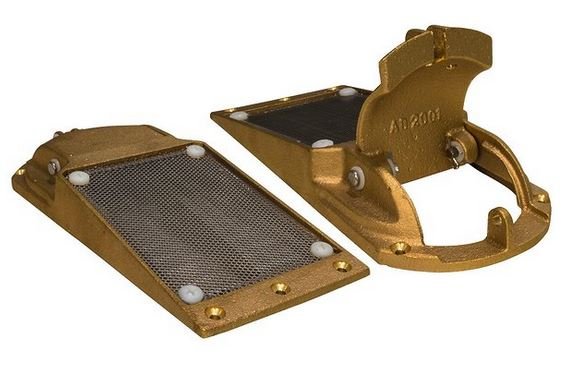

Re: Moving the engine seacocks
I added these over the through-hulls.
https://www.pricefalls.com/product/groc ... 7625501480
My boat came with the oval-with-slots type as you describe, but no strainers on the engines. I've never had any issues overheating, before or since adding the strainers shown in the link. Using the TLAR method, I installed the long axis of the strainers so that each points about 12 degrees toward the keel (fronts of strainers are closer together than the rear for dual engine). Why? Water doesn't just flow from bow to stern -- it flows out and away from the keel too.

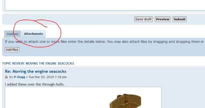

1). Save the pic on your computer.
2). Click "attachment" tab.
3). Select file.
4). "Place inline."
Voila!
So Since these screened covers attach over the existing thru-hulls, how are they bonded?P-Dogg wrote: ↑Tue Mar 05, 2019 7:18 pm I added these over the through-hulls.
Mine are not bonded And no issues
If you want to bond them, make one of the attaching screws a machine screw that penetrates into the bilge. Apply ring terminal there.
I do not believe mine are bonded. I boat in nearly fresh water. If i can remember ill report back after sprung haul out.

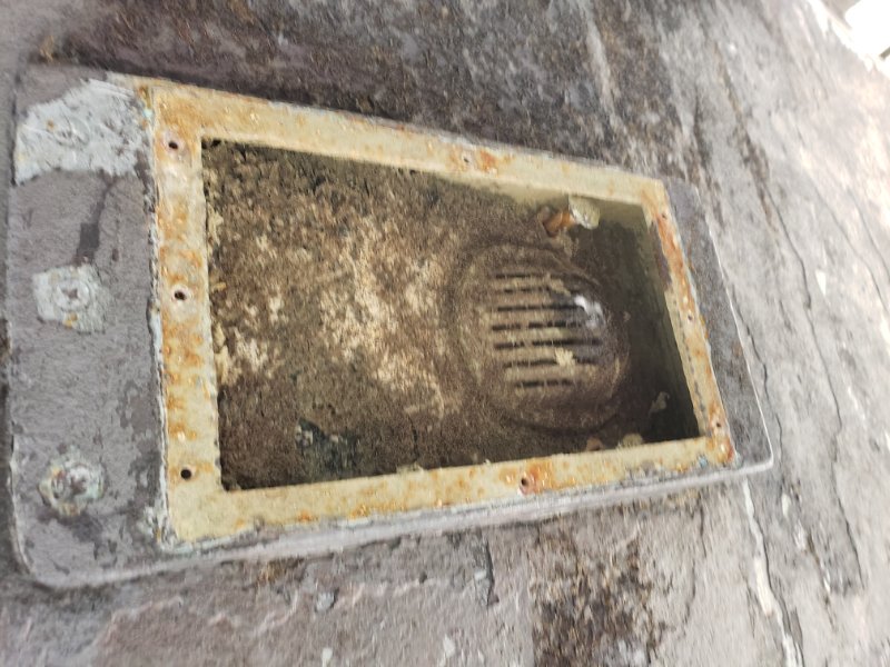

Hi, All! My first post here. I am replacing all of my thru-hulls on my 1982 F-32. The existing thru-hulls are a slotted clam shell type. Additionally, these are covered with the wedge shape screen as pictured above.
My question is should I keep the slotted thru-hull or can I replace them with a standard round open type. I will be reinstalling the wedge screens over the new thru-hulls. Any thoughts would be greatly appreciated.
Here is a picture of what I have. It seems like overkill to have both types of strainers. I will definitely keep the wedge screen strainers, not sure about the slotted strainers. Any thoughts?
No harm in leaving the slotted ones in .
