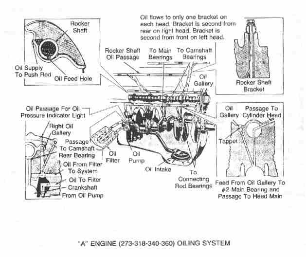

mpjosh2001 wrote: Thu Sep 19, 2019 8:08 pm
prowlersfish wrote: Thu Sep 19, 2019 7:50 pm Hollow push rods ? That sir is a part of your issue
Then how does the top end get oil? The chevy 350s, 396, and 496 all had them to oil the head. Does it come in through a port and you hope it runs all the way down to the back end?
Thats kind of how it works
Re: 318 no oil pressure
Posted: Thu Sep 19, 2019 8:29 pm
by mikeandanne
That is it. The oil comes up thru the head to the rocker shaft which is hollow and then goes to each rocker, spring and pushrod from there. Those shafts have to be installed in the right orientation or the oil will be blocked, but that would just make the pressure higher below. Who sold you the parts for this repair. A known good gage on the engine should show pressure when pre-oiling or there is a problem.
