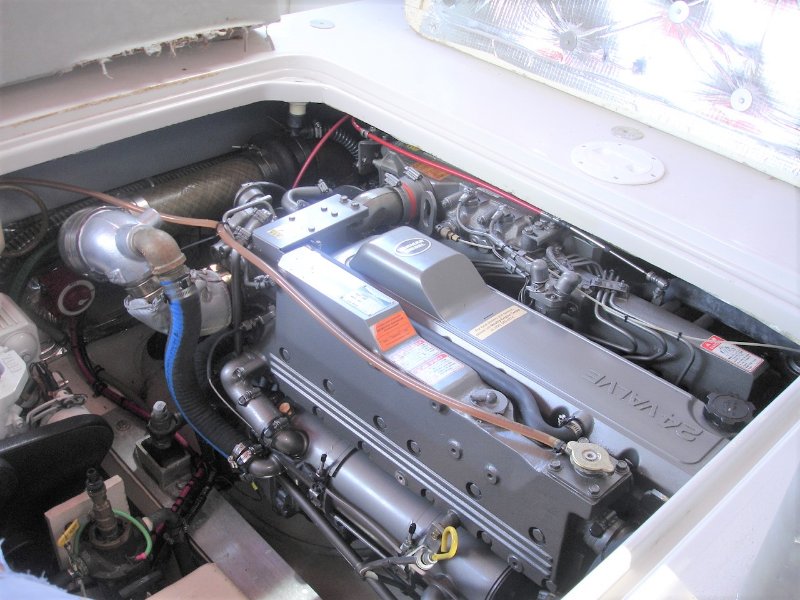

One of my motors
Just figured out picture posting :mrgreen:
