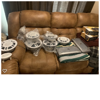

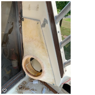

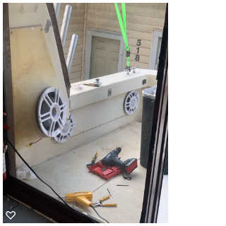

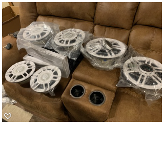

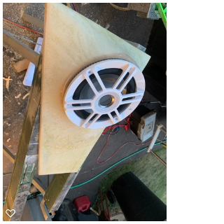

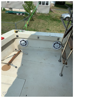

Of course had to start with some fun things, so got together what I wanted for the sound system, figured out the back deck placement, and got to work on that. Went with all Infinity, as it worked out great in my last boat. Finding space for the 10" subs proved to be a challenge, so had to make some boxes, and stuff them with polyfill to get the frequency down as low as I could. Been lazy, so haven't busted out the body filler on them yet. I did end up making them sealed boxes, adding on to the backs, as free air subs sound like absolute trash, otherwise.

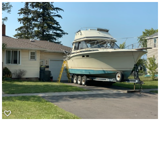

Now the hardest thing of this whole build, I have a feeling, is going to be finding a replacement flybridge acrylic windshield. That piece that wraps around the flybridge, to keep spray back I'm guessing. Mines cracked, and half of it is missing. No clue how I would get one made, or replaced. So if anyone has some solid leads or advice, I'm all ears.

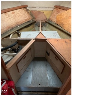

Re: 84' Trojan F32, in too deep?
Posted: Fri Sep 17, 2021 4:24 pm
by Velislide
Mine has a few soft spots up on the forward deck. Inboard stringers also will need to be done, engine room back. Leaving that for last, lol. Was being used as-is, but everyone has their own standards. Anything can be fixed. In the end, still far cheaper then a new boat, and more fun when its something you've slapped together yourself. Traded a wheeler for the boat, and plan on having maybe 10k cash invested into it. Unless I decide to repower, which I'd be going diesel for sure. Some GM LM2 engines would be a nice fit. Originally thought about doing 6.0 gassers, for simplicity, but why not be different I suppose. Those new LM2's are light, make similar power and more torque than the crusaders, and sip the fuel. That can wait though.
First step, get the interior done. Second step, exterior and fixing soft spots. Third, well, pulling engines and all that fun.
