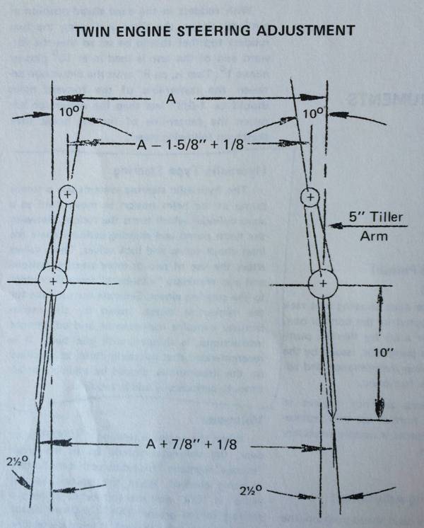

by captainmaniac
Rudders are definitely one thing to look at then. They are each supposed to be 2.5°toed out. Good luck finding whatever else is going on.
