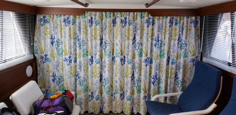

Our boat came with some very nicely constructed drapes at the salon door and matching curtains in the triangular windows by the windshield. My wife hated the dark colors and thought the pattern was like a boy's bedroom from the 60's. Needless to say, they had to go!
My wife and her sister grew up making their own clothes and both are accomplished quilters, so making new drapes was certainly something they had done for homes before and making ones for the boat couldn't be that difficult, could it? After looking at MANY fabric choices, we decided on what we wanted and she bought the fabric and other related stuff. I was assigned to replace or repair the existing track system and we worked together figuring out how to make the drapes less formal and more attractive. Her sister visited us a number of times to help out with the project, which was really nice of her.
This is what they looked like before:
Boat Drapes.jpg (197.61 KiB) Viewed 21575 times
I was able to reuse the original track and replaced the broken snap-in carriers with new ones. To keep the curtain hanging evenly, I used some string to limit the distance between the carriers to 2.2". You can buy carriers that come with the carriers connected by string, but I wanted to have the ability to control the distance between them. I also replaced the string that opens and closes the drapes.
The ladies made the curtains and I did not follow exactly what they did, but they did a fantastic job and all I contributed on the fabric side was to buy the snap tape for them and install the other snaps where they told me to.
As part of this project, I also replaced the old mini blinds with some higher quality ones and we removed the sleeper sofa and bought new Poang chairs from Ikea. The transformation is amazing -- much more cheerful and light. My wife no longer thinks the boat is from the dark ages!

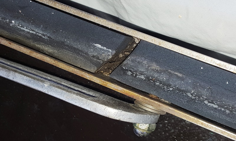

Our hatch seals have always leaked a drop or two, so have been on my list of projects near the bottom. All of a sudden, they all started leaking a lot! Here is what I found when I looked more closely.
Hatch Seal Old.jpg (189.46 KiB) Viewed 21507 times

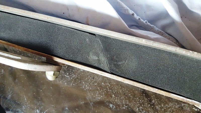

Some of the joints were OK, but the seals were hard and not making good contact. Other joints had failed and were also perpendicular to the hatch edge, rather than at a 45 degree angle. My wife freaked out and ordered an immediate fix!
Hatch Seal New.jpg (178.97 KiB) Viewed 21507 times
As part of a later project, I will remove the hatches, replace the plexiglass and have them powder coated, but this should keep us dry for a while.

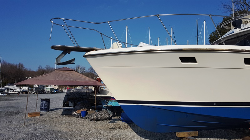

The anchor that came with our boat was a Danforth high tensile 20lb anchor, which is a pretty good match for a lunch hook, but not what I wanted for overnight use. After some research, I decided on a few anchors that would make me happy and waited for one of them to go on sale. I ended up buying two anchors that suited me. The first was a Fortress FX-37 refurb that was originally used during the cleanup of the Deepwater Horizon oil spill in the Gulf of Mexico. This will be stored on the boat in a disassembled state and used as a kedge and storm anchor. The second is a Super MAX 16 anchor that will go on the bow pulpit. The Super MAX is not all that well known, but some people whom I respect have them and like them, especially for the muddy bottom we have in the Chesapeake Bay.

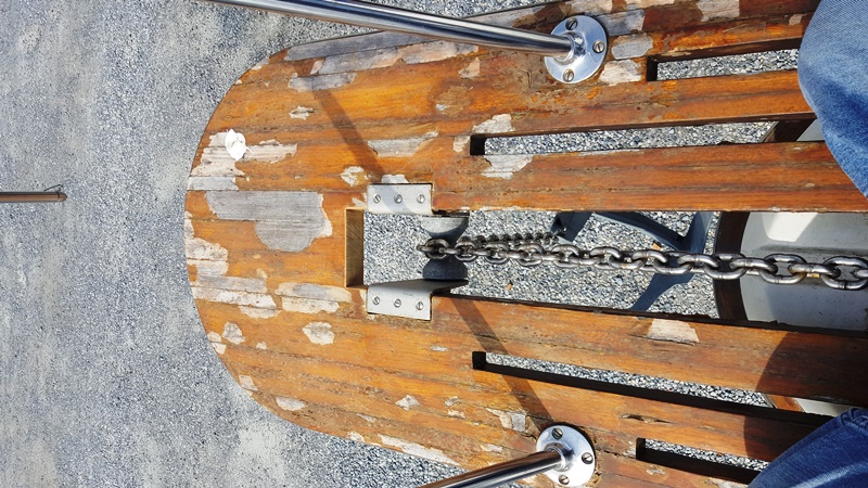

Of course, the new anchor did not fit on the bow pulpit, so I had to make some modifications. The slot for the anchor used to end at the pulley bracket, so I lengthened it by 1 1/2 inches.

Still to be done is remove the 40 year old anchor rode and winch in the new one that is sitting in a box in my basement. And of course, refinish the bow pulpit!
