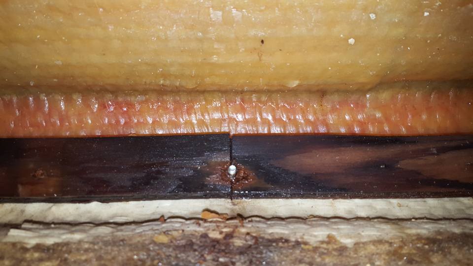

Oh I am so glad I'm not alone in the "open a can of worms" world :) My rub rail was also causing the interior to have a mold garden / water feature. I tore the whole bow out at well..... its a LOT of work!!

same problem with my rub rail. when i redid the interior i also replaced my rub rail with the tessilmare rail from jamestown. blends nicely into the boat.
