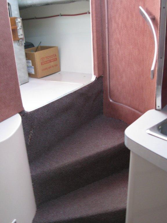

I am intrigued by the woodwork going on inside the cabin.
Would make a big difference for RWS if I killed off some of that Burgundy, Pink and well the grey is not too bad.....
the "Doris Day" Stairway during the refit remains unchanged today

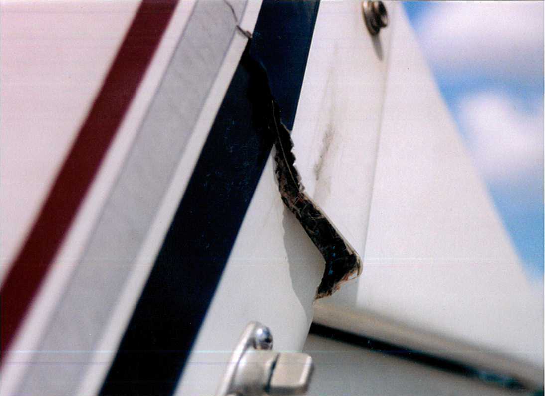

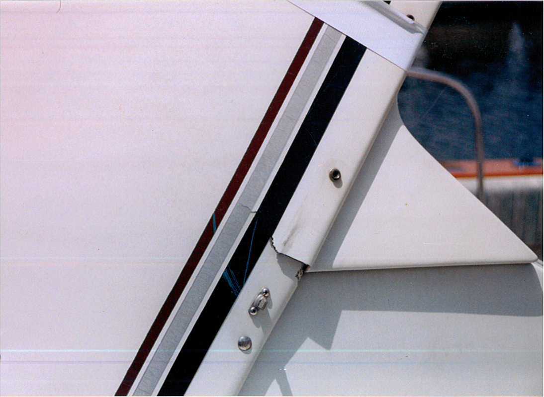

Hurricane Charley
Cat 4
Friday August 13, 2004
damage pix
The entire arch was barely holding on and required additional support with crossed 2x4's to keep it from collapsing when removal began

Wow! I cant believe the fiberglass skin actually tore! (must be the lack of wood in those express boats!! LOL :P ) I can understand why you went with the metal.
I don't particularly care for those little "triangles" . my arch has some stress cracks along the edge of the triangle where it attaches . not real sturdy attachment. looks like yours started to tear at that point . Thanks for the pics!
