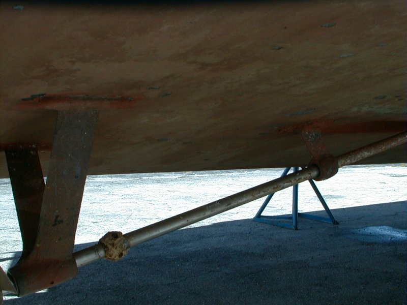

I wonder if RWS has photos of his boat's undersides?
Re: 10M Express what is the best prop?
Posted: Mon May 24, 2021 4:54 am
by RWS
these photos are from 2005, BEFORE the refit to diesel.
I have the original factory order paperwork on this boat, and can confirm she came from Lancaster with big block 454 Crusaders.
I sent these struts back to John for resale, after the refit was completed, as I ended up going to 1.75" shafts with one strut per side
I was told the reason 2 struts were required was due to the torque "twist" on the shaft, due to it's length/width.
If that boat was mine, I'd look into putting Aquamet 22's on her
Might be best to discuss this with John Leed first to see what his thoughts might be.
Photo taken before diesel refit.
Posted: Mon May 24, 2021 7:37 am
Interesting, the extra strut and the V-strut. I wonder if Trojan did that because of the big block or a change after the first year or 2?
One thought on the shafts is you have no more torque on them than when the boat had small blocks due to it having the 1.5 to on gear vs 2.0 . But you would be spinning them faster.
Do you know your shaft size offhand? Just wondering if that was changed?

prowlersfish wrote: Mon May 24, 2021 7:37 am Interesting, the extra strut and the V-strut. I wonder if Trojan did that because of the big block or a change after the first year or 2?
The photo is of a 1983 (actually a 1982 hull) with 2 struts per shaft (factory struts were 1.25")
Posted: Fri May 28, 2021 9:20 am
The early 10 meters did come with the I strut, so that is a stock set up.
