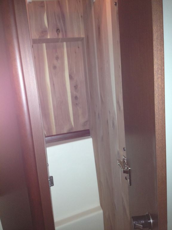

cedar wood lining in the closets..
bad idea?
Here's an example from the 2013 Miami International Boat Show.
Seemed like a nice touch.....
bad idea?
- Cedar Closet
- CedarCloset.JPG (36.83 KiB) Viewed 8466 times

I like the cedar. Would have been fairly easy to do since the walls are flat. Just so happened to have the carpet laying around. Besides whenever I'm on the boat all my clothes smell like fish, fuel and beer! Not sure cedar would help!
