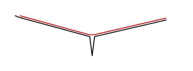

Dan,
You've made several references to the hollow keel in your boat. Is this somehow different from the bilge? Can you please explain what you're referring to?

Hopefully I did this right and size isn't a problem...
Very basic and crude depiction, and others can elaborate if they wish to, but in general this is what is being talked about. When you look at the hull from the outside, you see the black line - the hull shape and keel. If you look from the inside, you see the bilge as shown by the red line. BUT the red line (glassing across the bilge) is really just a liner that hides the fact that there is a big open space beneath - the keel is not solid, there actually is an open space between its sides.
Most boats have at least one hole or opening in the 'inner liner' that lets gobs of bilge water settle down there as well - which your bilge pump can't do a darn thing about. On my boat, I have to pull up the carpeting and floorboards in the lower cabin area to find these openings - everything from the engine compartment bulkhead back is solidly glassed over.

Captain M,
I learn something new every day, even after years of reading about Trojans. I've seen references to the hollow keel before, but I guess I haven't paid attention.
Your sketch and explanation are very clear. Our bilge is completely glassed over as far as I know. From the forward engine bulkhead back, access is almost impossible what with the battery boxes, generator, and water tank.
In the lower cabin area, the floorboards are easily removed, and we clean that area about once a year. We've never discovered any openings in the liner in that area. Are you saying that it was designed with holes in it? I wouldn't be surprised if ours has been changed.
So what are the approaches to dealing with this situation?
