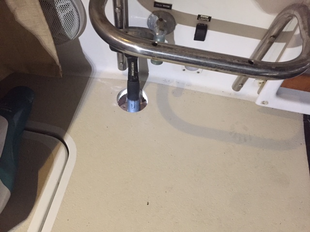

I'm in the process of replacing both now. Here's what I know so far and pic of the Stb side hole cut out. I wanted to go as small as possible given the location and the likely hood that it will be years before I need access again. So, I'm using a 3.5" flush cover plate instead of a deck plate with a flange. It's just a flat piece of plastic with four screw holes. I sealed up the balsa coring and will drill/fill epoxy for the screw holes. The small size means you have to cut a pretty precise hole but the diameter of the sending units are really small. If you're more inclined to go with a deck plate, 4" is plenty big.

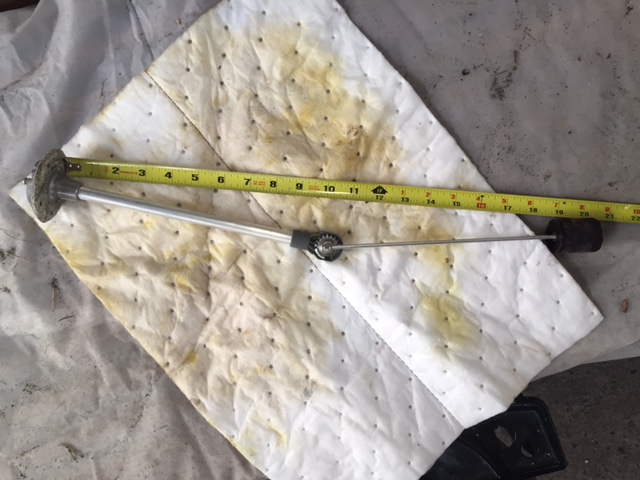

I'm using 22" Moeller mechanical arm sending units which are a hair longer (about an 1") than the original units. I'm also replacing the conversion capsules which sit on top of the sending units. That's the part that magnetically calculates the level and sends that signal up to the gauges. Credit Todd Pote for explaining that to me last year. The add'l length should not be a problem unless the arm actually bottoms out on the tank AND I ran until almost empty. I'm never under a 1/4 so I'm not worried about that. I even considered going with a 17" which would give a much bigger reserve.
I'll update with some dimensions when I'm done.
P.S. - that's a sledgehammer holding the cover plate down until I can do the install

I spent a full 5 minutes staring at that picture until I read the P.S. part to figure out what that was! :lol:

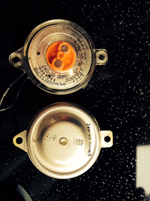

Here are a couple of more pics. One is the "conversion capsule" which attaches to the top of the sending unit with two small screws. The conversion capsule uses a magnetic signal to interpret the physical location of the float and send that information up to the gauge. If you are replacing the original unit, you will need to run a new ground wire, the original only has one wire. The pic shows the new and old units upside down. On the other side is a functioning gauge. In a pinch, you could check this gauge if there was an issue with the gauge or wiring from the sender up to the helm. Moeller sells the conversion capsules but they're made by Rochester gauges.
I replaced the factory senders with Moeller 22" units which are slightly longer than the originals. Some people have noticed a difference in length between the two tanks. I did as well but it was only about 1/2"- 3/4". I used 22" on both sides. The factory floats were cork and definitely giving me flaky readings because they were satured. A better option might be the WEMA senders.
As other people have posted, it is imperative that you seal the balsa coring all around. If you have an access or deck plate already installed, I would make it high on the list of things to check. My deck is bone dry and I plan to keep it that way. I'll do another update when I remember to add some measurements for the hole.
