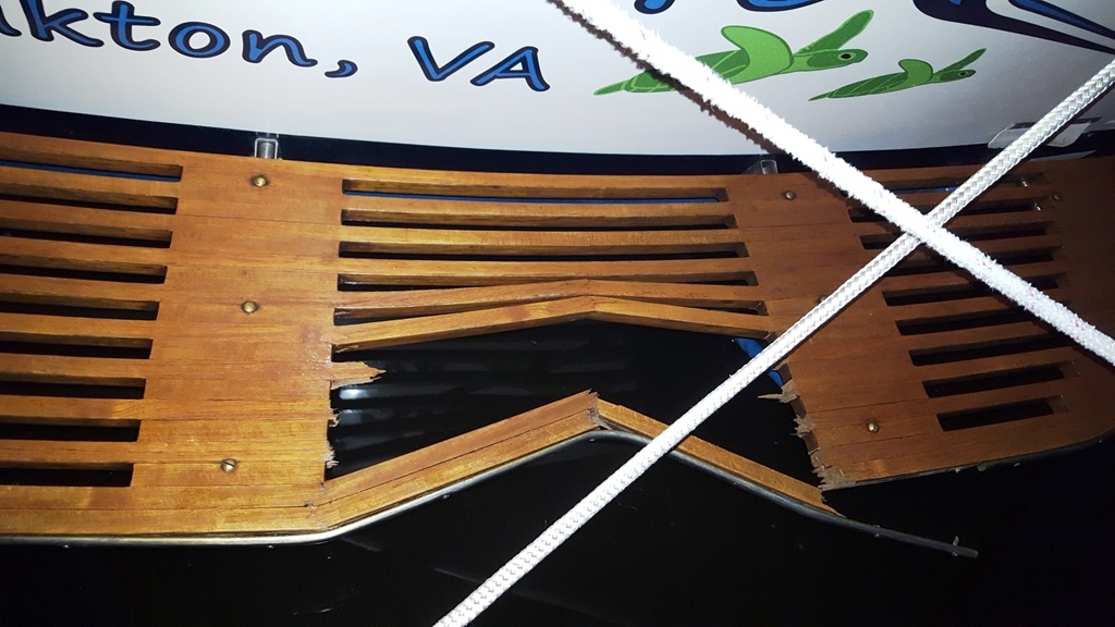

Here is a photo of the damaged swim platform. As you can see, it made a pretty good shock absorber, but did a lot of damage to the platform! Of course, I had recently spent quite a bit of time refinishing the platform...

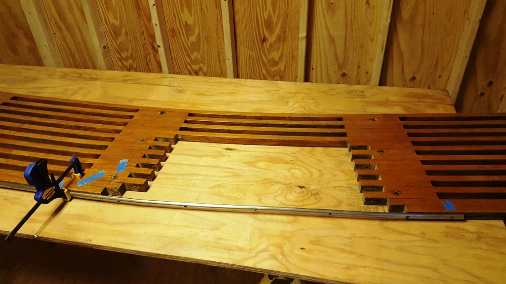

Anyway, I set up the platform on sawhorses in my shed and figured out a plan of attack. Rather than rebuild over half of the platform at a very high cost, I decided to just repair the local area where it was damaged. A hardwood supplier in Annapolis had some small pieces of teak that would work. I needed 7 pieces of wood that were 1" x 1 1/4" x 36" to replace the broken slats.
The first step was to remove the stainless steel rub strip and cut out the broken slats. After cutting off the broken slats, I trimmed the ends cleanly using a router and a couple of guide boards.

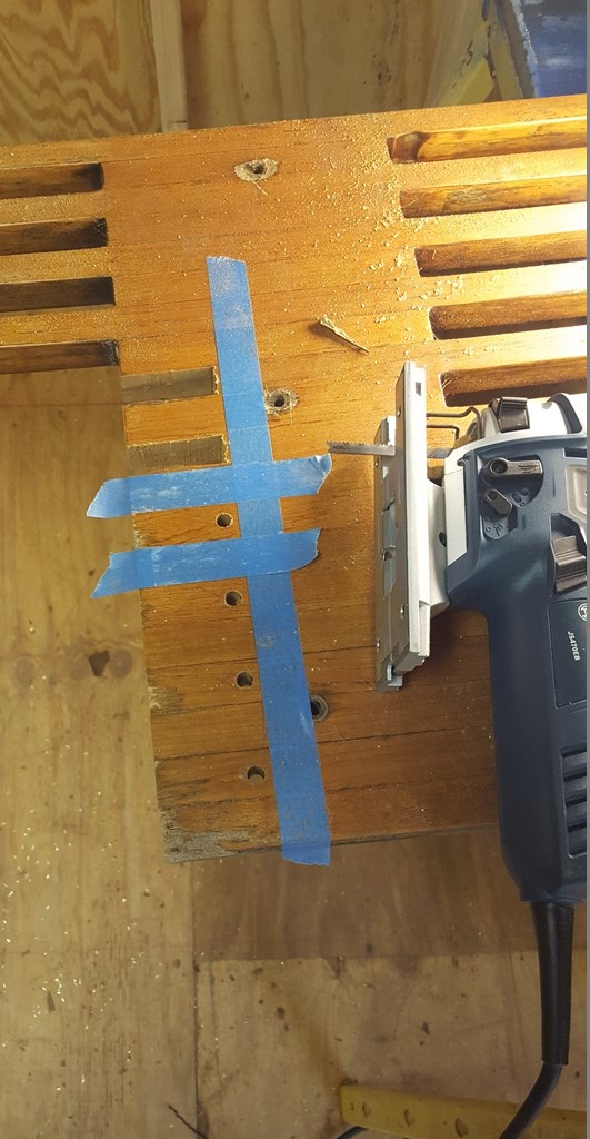

My plan is to route out 3" slots for the ends of the replacement boards to fit into. This is complicated a bit due to the curvature of the individual boards making up the platform. More about that later...
To control the router, I initially cut a plywood template to use as a guide while routing out each slot. This turned out to be very time consuming and wasteful of plywood when I had to make minor changes. It worked OK for the first slot, where I ran into a new problem. There were silicon bronze screws holding the individual boards together and they are harder than the wood, so when the router hit them, it jumped.
Time to go back to the drawing board. I decided to rough cut each slot and only route the final edges.

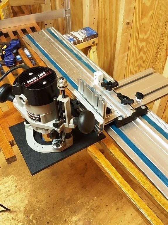

Also, while reading a very interesting boat repair blog (https://1969chriscraftroamer46.wordpres ... cle-index/) I came across a router guide that works off a track system. Since I already have a track saw, I was halfway there towards this system, so I ordered one for the project. It will come in handy for working on my kitchen cabinets later on anyway, at least that is what I am telling my lovely wife!
This is the Super Smart Routing Kit from EurekaZone. It gives you slides in the x and y directions, and with a plunge router, you have z axis control as well. Kind of like a portable milling machine for wood.

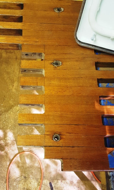

After multiple depths of cut on each slot, here is how things are looking after the routing step is completed.
Routing Complete.jpg (167.32 KiB) Viewed 12593 times
I still have to square up the edges of the slots before fabricating the new slats. If you look at the last photo, you can see the ends of the silicon bronze screws on the edges of the slots. The carbide tipped router bit cut through them OK, but I had to be on top of things when I hit them!

Back to the swim platform. I was able to spend some time on it and have it ready to fabricate the new slats. I hit a hidden stainless steel screw and chipped my new Freud router blade. Luckily, even though one piece hit me right below my safety glasses, it did not deflect into my eye!
The edges were squared up using an oscillating tool freehand. The top is quite good, though I did not worry as much about the bottom and will fill any minor gaps with epoxy thickened with cabosil and wood dust. I was happy to find that the rub strip screws fit without having to bend the platform, so I am confident that arc for the curved transom is still correct.

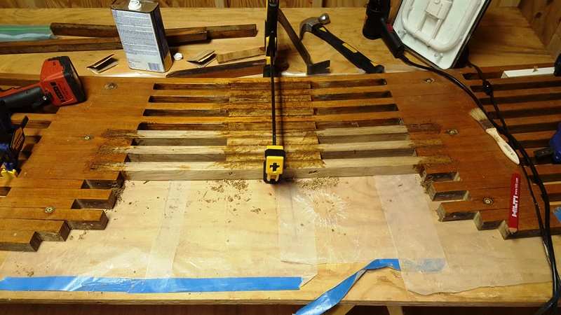

Now to the rebuilding part. Part of the strategy is to add a swim ladder to replace the bulky one stored under the cockpit next to the generator. To do this, I am adding another row of spacers in the middle of the repair, partially to mount the swim ladder and partially to make the new pieces arc the same as the existing long ones. The swim ladder will also add rigidity to the repair.

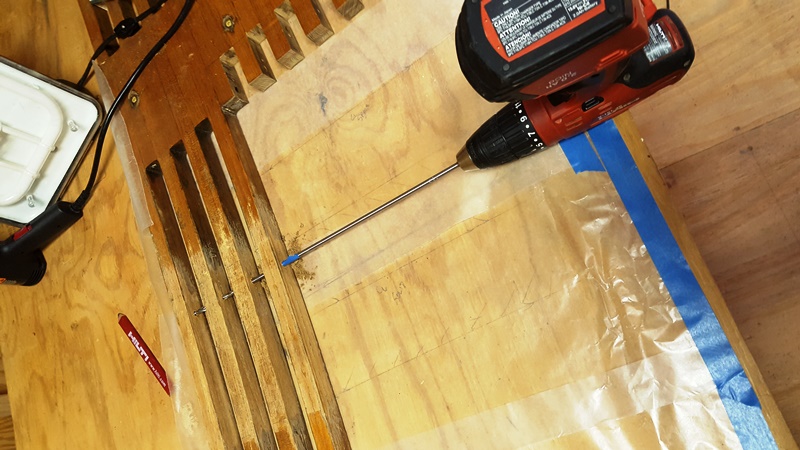

First, I had to add the short pieces between the unbroken stringers. There is no easy way to use screws, so I drilled through all but the last one and epoxied two 1/4" stainless steel rods in place. The next short piece will cover up the hole and the stainless rod will be embedded in the platform with no openings visible. Here, I am drilling the hole for the rod.
SS Rod.jpg (153.76 KiB) Viewed 12371 times

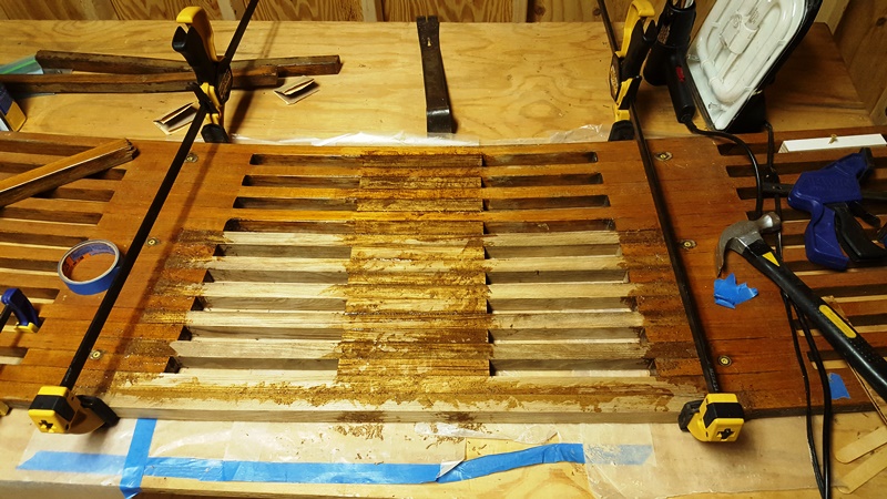

Once the holes were drilled and I had fabricated the teak pieces and drilled them, I began the assembly process. After some research, I decided to use West Systems G/Flex 1:1 epoxy because it is slightly flexible and designed for gluing difficult to bond woods. They sell a pre-thickened version, but I got the standard one and thickened with cabosil when I needed to.
Bending the new long boards around the spacers and getting the ends into the slots was a difficult process. After cleaning and applying the thickened epoxy, I put one end in the slot and used a clamp to bend the board until I could tap it into place with a hammer. Once everything was aligned, I added the screws and clamped until the epoxy kicked. I further thickened the remaining epoxy with teak sawdust and filled any cracks and holes.
Assembly 1.jpg (174.64 KiB) Viewed 12371 times

Assembly is done, time to sand and finish! I can't wait to get the swim platform back on the boat, it is a real pain not having it!
