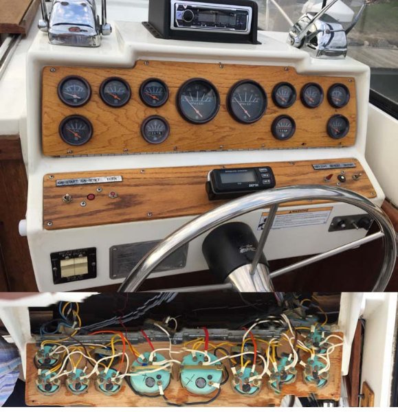

Very helpful - I would like to replace my gauges. I know gauges differ by the type of engine and drive. My gauges are plastic backed and green see attached. Do I need to replace the sending units when replacing the gauges?
Thanks Jimmy

Your gauges will need to match the senders .You may be able to get gauges with the same specs. I don't believe your gauges are the original . Any close ups ? If I zoom in they get blurry

Why are you replacing them ? Any issues

I believe those gauges are original as they match what was originally on my '79 F32. I understood they were 'DetMar' gauges - Detroit Marine - but have never been able to confirm it. I replaced mine with some new Teleflex gauges that were compatible with existing senders.

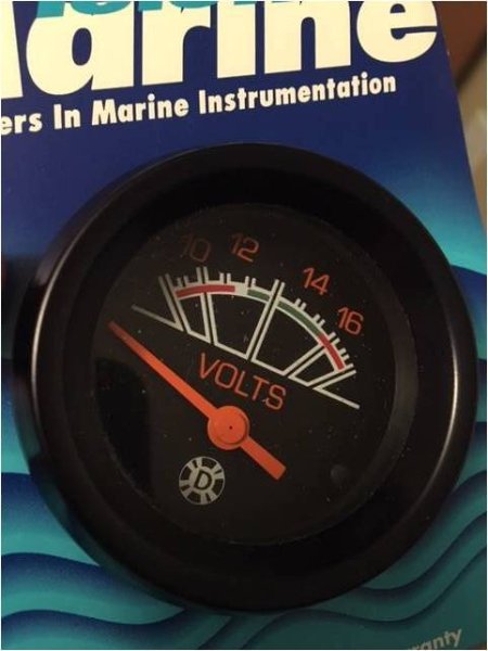

It was way too long ago that I don't remember... If I remember correctly there are 2 primary types of senders - one is based on current, the other based on resistance. What I replaced the old gauges with was Teleflex Red International, which worked with whatever senders I had. I had a tach blip out a few years later and replaced them with new Teleflex Amega ones (since Red Internationals were discontinued by that point).

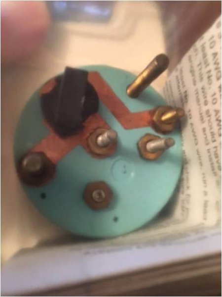

Here is what one of my old (original) gauges looks like
One other consideration as Bob indicated - single vs dual station setups require different senders. If you only have a single station and are adding a new set of controls you would need new sender. If you are dual station right now and are disconnecting one set of gauges, you may need to switch to 'single station' sender. Also make sure you get stuff for inboard engine vs outboard! But if not changing configuration, if you research what what kind of sender the teleflexes need, that's probably what you have.
EDIT
Just took a closer look at the packaging from one of the Red International Water Temp gauges and sticker says 'For Code D Sender' looked. So did a quick search and found this http://gfretwell.com/electrical/teleflex%20senders.pdf From this you can see a Code D sender for dual station is 120ohm at 120f... so you can probably use this to figure out what senders you probably have and then find new gauges compatible with those specs.
