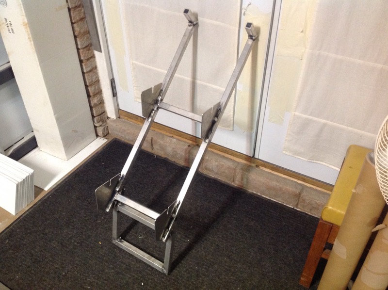

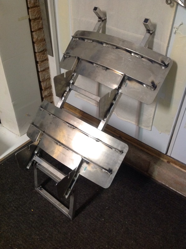

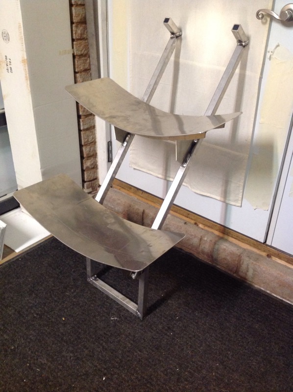

Designed & built this folding companionway staircase for my Sailboat using 0.125 and it is very strong. No warping problems with this during the welding process, so we'll see with the arch.
