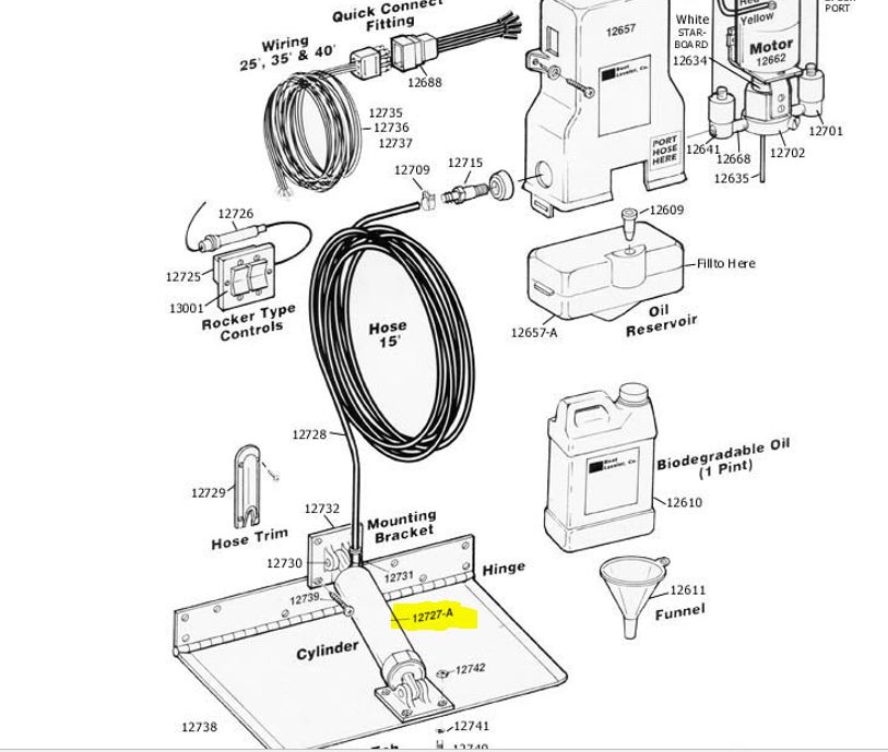

Posted: Sun Jan 28, 2018 5:35 am
by zbigk
Trim Tab Spec.JPG (80.93 KiB) Viewed 18669 times
Re: Insta Trim / Boat leveler parts
Posted: Sun Jan 28, 2018 9:35 am
I don't see seals listed , but being the cylinders are plastic good chances they are worn too . I would just replace the cylinder(s) as they are inexpensive .
