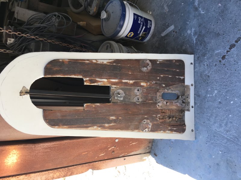

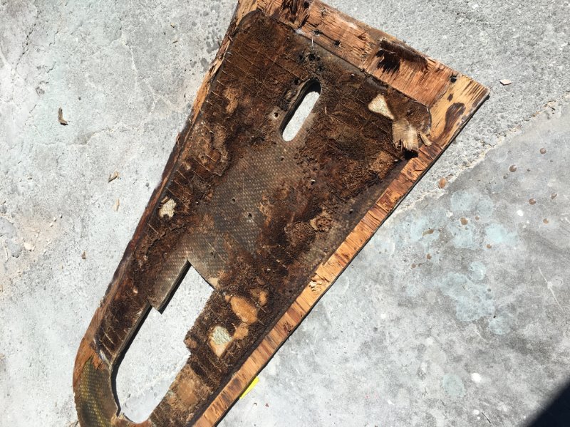

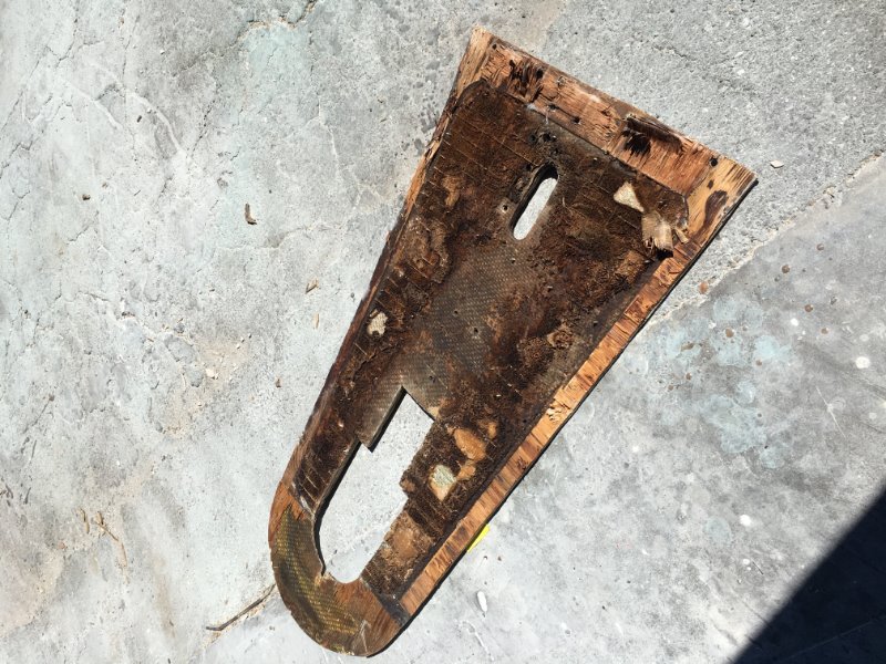

I added a Lewmar Freelall 600 in 2001, 17 years ago to my 10 meter
it was adequate at best
deploying was always perfect
lots of issues with the clutch and gypsy on retrieve
difficulties in getting the clutch to engage, and the gypsy would occasionally spin on the rode
despite mounting it as far aft as possible, its design allowed it to dump the rode too fat forward in the anchor locker, where it would ball up at times during retrieve.
During this years refitment, while I was replacing the water soaked balsa, I upgraded to the GOOD freefall windlass.
I will ATTEMPT to post some photos.
Meanwhile, DO YOUR RESEARCH before selecting a windlass AND DON'T UNDERESTIMATE OR SKIMP ON THE WIRE SIZE

more photos here:
Re: Windlass for 10 meter
Posted: Sat Sep 29, 2018 6:11 am
by RWS
and a few more:

It should be noted that we extended the bow pulpit a bit to the rear, shortening the door to the rode locker.
This was done to INSURE that the rode would be dumped as close as we could get to the deepest part of the locker
I'll get some finished photos taken this weekend and will post
