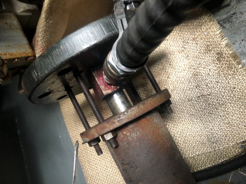

Holy !@#$. I can't get those shaft couplings off. I tried my buddy's home made press with 4 bolts and a socket on the other side of the plate to push out the shaft, no luck. I added some torch heat, no luck. I quit. I punted to a mechanic who is going to bring his hydraulic press. Keeping my fingers crossed. I opted to buy the maintenance kit for the PSS dripless, I like a dry bilge. Once the shaft coupling comes off, the rest is a piece of cake.

Put 6,000 lbs of pressure on the hydraulic press and it still wouldn't move.
Got an oxy-acetylene torch on it. It got serious. Finally it popped.
Guessing two possibilities, 1) previous owner/installer installed the couplings with a method called interference fit, where you heat the right before you put it on the shaft so when it cools it will be a super tight fit, or 2) the tapers don't match.
Either way sent the prop, shaft and coupling to Bossler & Sweezy to get all cleaned and trued up.
See what they find out.

I have some spare shafts with couplings that had a set screw that screwed up against the shaft. They moved fine until the burr from the set screw got involved. My OTC 7-ton puller wouldn't even budge them, even with an impact gun (and yes, I know you shouldn't do this) and Mapp gas. Next effort will be laying my 20-ton press on its side and seeing if that along with some more heat won't get it moving better.

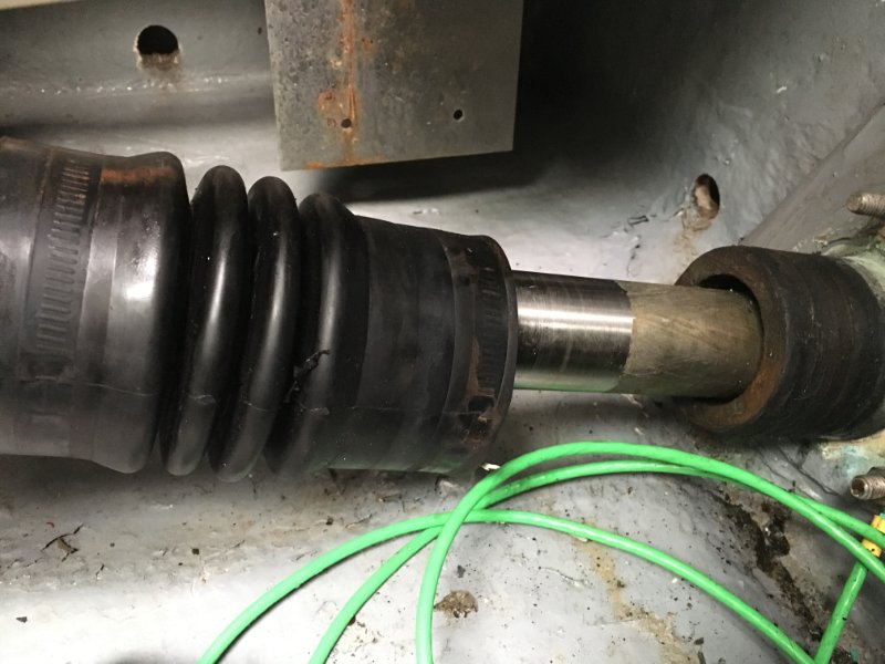

the old, rotted hatch allowed water to drip down on the starboard side coupler over time.
had to make a trip to Home Depot and invest in a Milwaukee 3/8" electric impact gun.
Popped the couple bolts off like BUTTER!
AMAZING TOOL !
Had a hard time sliding the shafts back, as the existing PYI collars are on fairly tight.
Took some #400 to smooth down any possible small burrs on the shafts.
Had I done that first, might have been an easier job.
The 6 cylinder in line Yanmars are narrower and LONGER than the Crusader big blocks
The presence of the PYI collar and bellows also take up space, resulting in 4.75" distance now between the now separated flange couplings
Not enough room for a conventional 3 finger puller
If I knew the bolt pattern, I could easily fashion my own 4 bolt puller out of a piece of flat steel, instead I bought one that will fit my space on line for $32 plus shipping
The new version of the bellows is supposed to be replaced every 10 years, so I'll be ready to go then :D

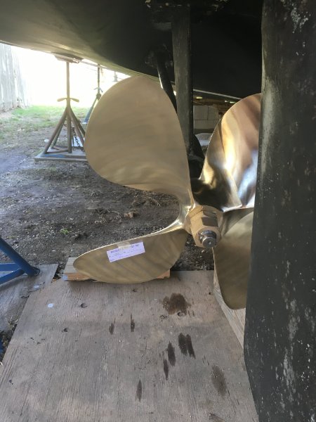

Some more pics.

The metal shaft collar on my 1983 (hull laid late 1982) Trojan International Express is actually 3"
This is the size I needed to use for the replacement PSS/PYI shaft seal bellows.
This may not apply to all Internationals, so it's best to physically double check yours before ordering
