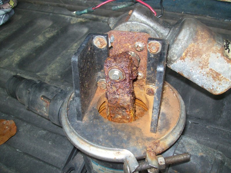

Did they sell this boat with a standard marine flush type toilet and made the vacu-flush an upgrade, as done on some other boats???. I note there is caulking around the toilet rim just below the area of the seat. Can you lift out the toilet? Is that how you rebuild the seals there?
Got the vacu-flush pump out today. Picture attached. Looks pretty rough to consider rebuild. Don't know about Vacu tank.
Toilet does not seal and hold water.
Thanks for the toilet reference. Will look into it.
Re: Changing toilet system from vaccuflush???
Posted: Sat Apr 06, 2019 7:31 pm
I believe it came std with Vacuflush bit not sure . Not sure about the head it self on rebuilding bit the rest is junk and needs replacement

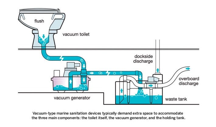

fighterpilot wrote: Mon Apr 08, 2019 10:12 am Come on, I'm asking for the latest and best information on other marine toilets, looking for up to date information on the best ones under $500.00 since I am not going to go with vacu-flush. I have one or two suggesions. Other forums are helpfull and I know this one has some good info to offer as well. What is the lastest info available on them. Thanks.
If my vacu-flush broke, I would pay whatever it would cost... to replace the whole system with a brand new .... vacu-flush.
Vacuflush System.jpg (39.36 KiB) Viewed 13209 times
