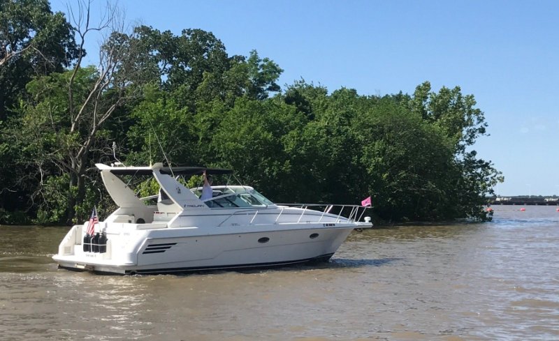

Anyway, I bought a 1997 Trojan 390 Express (some pics attached for anyone who is interested). If I understand correctly, Carver Yachts purchased Trojan in 1992 and continued to manufacture the 390 Express through 1997 until it subsequently transitioned to the 400. Some would say of course mine isn't a 'true' Trojan but rather a Carver while Carver enthusiasts would say it's not a Carver, it's a Trojan! So now, you can see how I'm caught between 2 worlds. Fortunately, all of the original manuals were left intact with the vessel so generally information, schematics and part numbers are readily available for reference. I hope that when it comes to actually locating replacement parts, I find the same to be true. Either way you look at it, she's a great vessel and I'm excited to have begun this journey.

First, I totally goofed and didn't attach pics as intended (I think I got it this time so see below). @Rickalan35 - You asked about the engines. I'm fortunate to have MerCruiser 8.2L 502s - yikes! They purr like kittens too. If you have the dimensions of the cushions, that would be great. If not no worries. Seems that's the one thing not in the manual - shapes/drawings but not dimensions. @WayWeGo - Thanks for the information, I'll check it out.

Those are great photos. I've been a member here for thirteen years and still don't know how to post photos. At one point I did, but that photo service provider disappeared (forget their name)........ and here you are posting photos on your first day. :)
I too have those 502 Bluewaters in my '94. They were an expensive option and we're both fortunate to have inherited them in my view. Unlike your Kohler my boat came with a Westerbeke generator. Your Trojan looks pretty much looks like a low-hour boat to me because of the great shape of the upholstery and interior wall surfaces etc.
