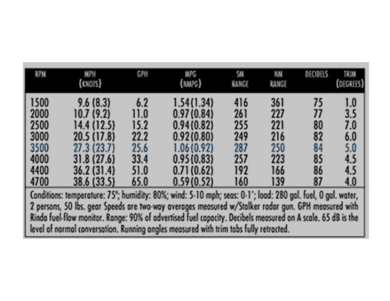

additional performance info (from my files)
keep in mind, these performance figures may be skewed by the manufacturer loading the boat as lightly as possible, etc
I'd certainly consider this with a grain or TEN of salt
FWIW
Looks like 3500 RPM will be the sweet spot on the 8.1
If it can push this 18,000 lb vessel at nearly 24 kts @.92 nmpg (1.06 mpg) I might do just a bit better !
RWS should be all the way up on the delta portion of the hull at that rpm/speed.
Your thoughts ?
