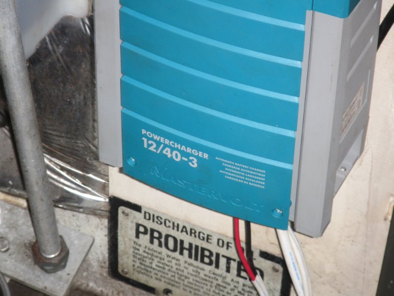

We love our Mastervolt, and the remote monitor we installed in the panel.
