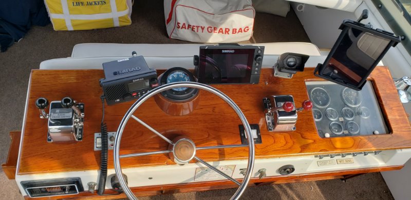

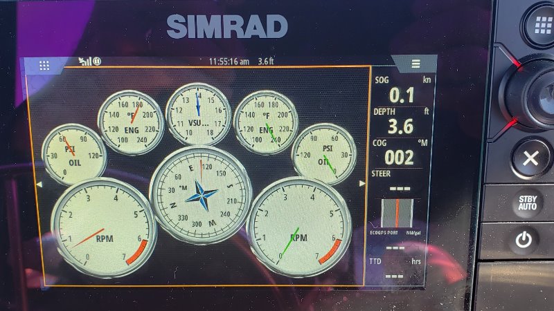

Here is what the gauges look like on my Simrad chartplotter. Only the port engine was running when I took the photo.

Looks nice . I had thought about it but I cant see tying up a1k MFD on engine gauges . One question why is the starboard oil pressure gauge back wards ?? Leave it to me to notice :mrgreen:

The resister is in the wire going from the terminal block to the RS11. Since the impedance of the temperature sensor is much lower than the input impedance of the RS11, adding even more resistance has almost no effect.
That's hilarious about the backwards gauge!

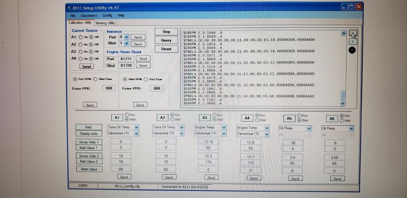

Good question! I was using a high quality infrared thermometer on the thermostat housing to get temperatures and recording them with the voltages I saw on the RS11 configuration utility. Since this type of temperature sensor is not linear, you have to record a range of temperature/voltage pairs and pick two in the area you are concerned with. In this case, I picked values at 105 and 180 degrees F. You input these into the configuration utility and it calculates the equation of the line that passes through these points and sends that to the RS11 so that it can calculate temperatures from voltage levels.

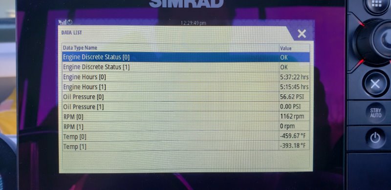

To check it, I used my helm gauges as a rough test to make sure I was in range. They are only graduated in 40 degree increments, so not that precise. Also, my chart plotter can display actual readings through its settings menu so I could verify that the temperatures it was seeing corresponded to my infrared thermometer readings.
Here is a photo of the configuration utility:
And here is a photo of the data display in my chartplotter's settings menu:
As you can tell, these photos were taken with only the port engine running and were before we resolved the issue with the AC Delco gauge voltage levels.

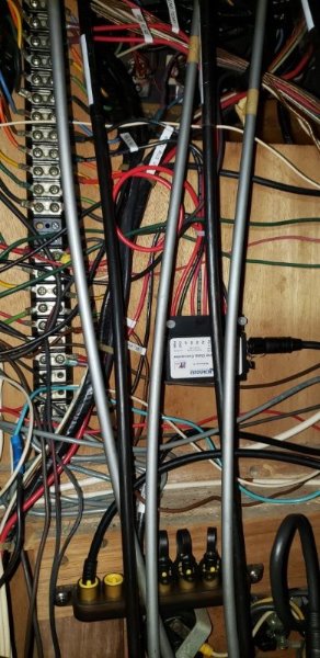

Looking over this thread, I realized that I never described how I connected the RS11 to the physical gauges. The RS11 is mounted behind the lower helm and the connections are all made to the terminal strips installed by Trojan.
