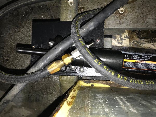

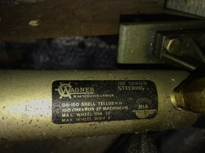

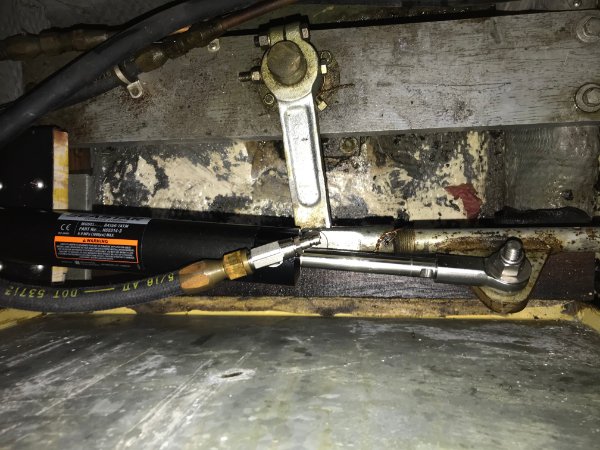

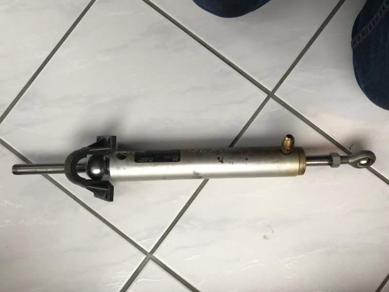

I removed the existing, leaking, Warner cylinder, although the Trojan mounting plate was substantial (3/8" thick steel angle) I was surprised to see the rear mounting on the cylinder ball was plastic, it was definitely the weakest link in the system. I opted for a new Seastar cylinder with the same bore and stroke. It is better built like an NFPA cylinder while the Warner seemed more like a throwaway. Unfortunately the new cylinder body length was 3 inches longer so I had to fabricate an adapter plate. The built-in bleeders on the ports are also nice. Ignore the water line, it will be moved later :wink: .
Old Warner, leaking both ends
New mounting plate
New mounting plate
New Cylinder
New Cylinder
paskyhawk
Posts: 27
Joined: Tue Aug 13, 2013 10:32 am
Re: Steering piston leaking
Post by paskyhawk »
I meant Wagner, not Warner.
