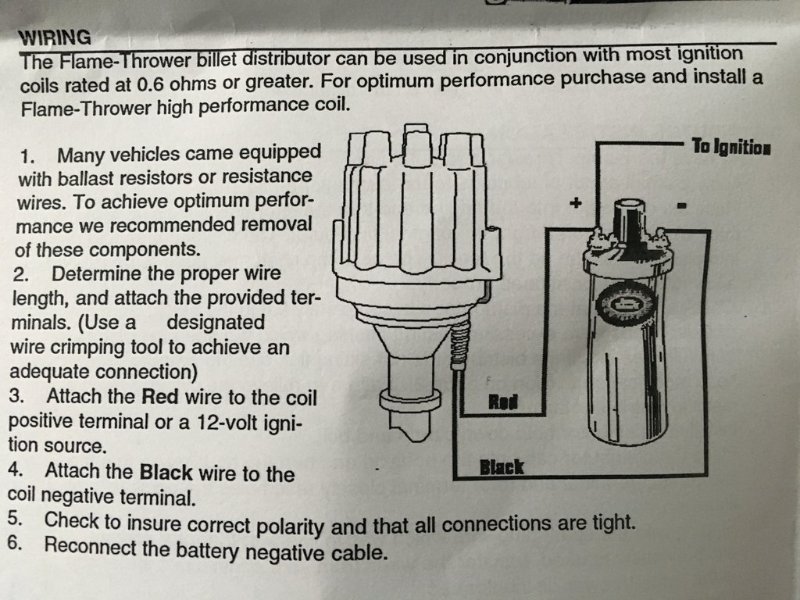

I installed the distributor and new coil. Can’t get it to fire up. Bypassed and removed the ballast resistors. What wires need to be connected to coil along with the wires from the distributor?
Re: distributor replacement M360
Posted: Thu Apr 21, 2022 6:31 pm
TADTOOMUCH wrote: Sat Apr 16, 2022 1:46 pm I installed the distributor and new coil. Can’t get it to fire up. Bypassed and removed the ballast resistors. What wires need to be connected to coil along with the wires from the distributor?
Make sure you have 12 volts to the coil + key on and cranking Did you hook it up per the diagram? If yes try disconnecting the tach wire .

What about the voltage regulator box do I still need that plugged in? I can't get this thing to fire up. I have the #1 lined up with the rotor on the compression stroke and the correct firing order but can't get her to fire? If I unplug the factory module I get no spark. When I crank her I only get one spark from the coil to ground then nothing else after that first spark. Any help would be appreciated. Very frustrating for something so simple.

TADTOOMUCH wrote: Mon Apr 25, 2022 1:50 pm What about the voltage regulator box do I still need that plugged in? I can't get this thing to fire up. I have the #1 lined up with the rotor on the compression stroke and the correct firing order but can't get her to fire? If I unplug the factory module I get no spark. When I crank her I only get one spark from the coil to ground then nothing else after that first spark. Any help would be appreciated. Very frustrating for something so simple.
A question, how did you bypass the ballast resister? I believe the start and run wires to the ballast should have been joined together.You need power from the key to ignition in both positions.Test it with your multi meter. The volt reg is needed to control alt unless you have an alt with internal control. Those little boxes are a bit finicky but generally they just fail, try the one from the other engine.

What is your source of 12 volts to the coil ?
