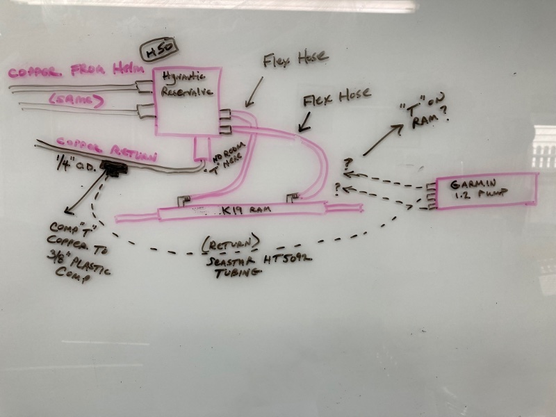

Thanks guys, here’s what I am dealing with. A couple of questions, I’ll give Seastar a call tomorrow as well:
1) does the AP care “where” I make connections? On the return line, I thought I could replace the fitting on the Reservalve with a T but there’s not enough room. I think I’ll need to install an inline compression T in the copper line. 1/4” OD.
2) Are the fittings on the steering ram “JIT”? They look like SAE 45 but from everything I’ve read, both fittings do look similar
3) asking question number two because the easiest solution would be replacing the fittings on the steering ram with a T if that’s a viable option and I can find the right size. That would handle my four primary hose connections.

For future searches, I wound up removing the Hynautic Reservalve and upgrading the helm pump (I have both old ones for sale). With the pressurized Hynautic system, there is some question with Garmin as they specify running at a lower pressure (10 PSI max). Seastar thinks this is a bad idea and even though it worked fine on the hard, there's no load on the rudders. I have the Garmin 1.2 pump but I believe this is a non issue with the upgraded Smartpump.
As far as the hydraulic connections, I ran a new return line up to the helm. I couldn't find a compression fitting for the 1/4" copper. The port/starboard copper lines are 3/8" so I left those and used Seastar 3/8" compression "tube nuts" which easily connect the copper to flex hydraulic hose (with 3/8" threaded connecter in between).
I've gone as far as I can with the boat on the hard and will finish up once I can test in the water.
