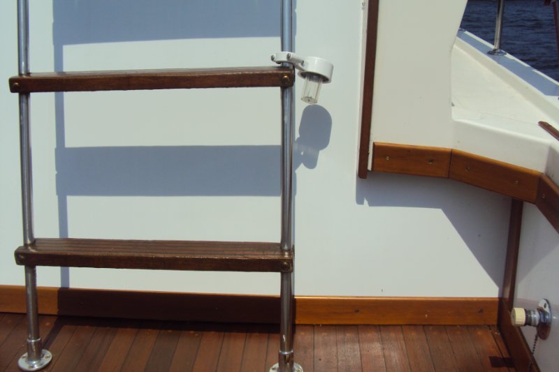

Yep heres the back! Needs a little love on the teak and all. Image
Re: New Tricabin Owner
Posted: Mon Feb 06, 2023 8:40 am
The Aft wall was plywood and made to be removable. You do have the aft engine correct? Later models had the engines under the salon floor. Aft decks were known to leak many owners fiber glass the aft decks to fix the leaks many are rotted.
Do you have the model number? Its located on plate on or by the electrical panel
I would do something about your Power cords in the water.
