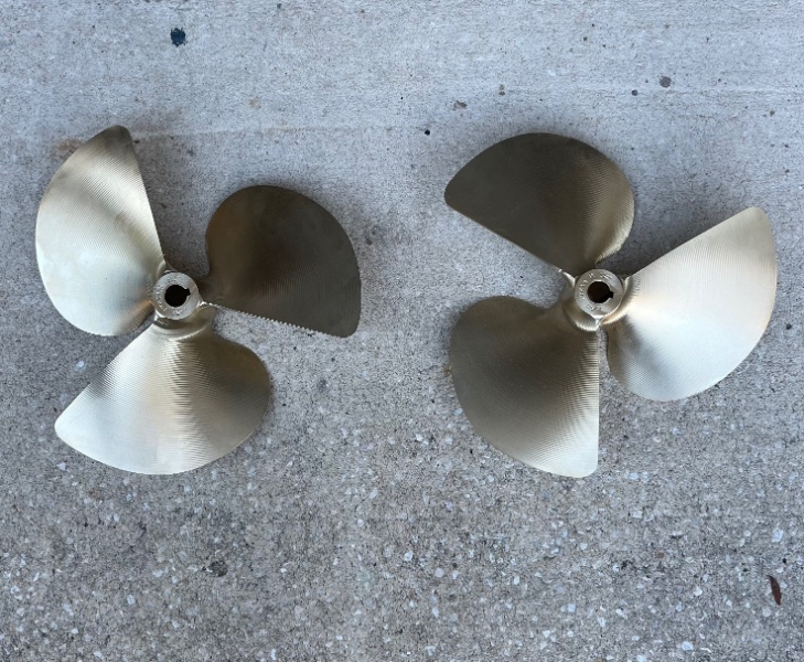

Update: after an hour of discussion with one of the Acme propeller engineers, going back and forth with numbers, we’ve decided on the following Acme propellers:
Looking forward to putting these on next month to see what improvements. More to follow with before and after numbers…

Yes, the engineer at Acme, based on my numbers (3900 rpm at 19 knots, tabs all the way down, boat length, beam, weight, etc...etc..) recommended going up to a 17 inch and down to a 14 pitch with a .030 cup.
They are really interested in getting my numbers up around 42-4300 rpm and about 25 knots. The engineer told me to keep the boxes because if the numbers aren't where they think they should be, he wants me to send them back and let them tune them until we are both satisfied. A real good experience with these folks so far. I couldn't be happier, even if the numbers cannot be achieved, I'll still be pleased with their customer service and willingness to make me satisfied.

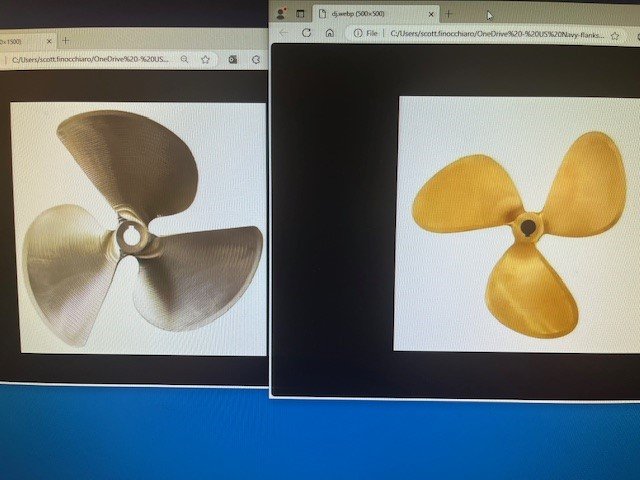

I'll definitely report back on the improvements/changes once done. My decision to stay with three blades vs four came after having it explained and now understanding more of the dynamics and characteristics of a couple of types of propellers...my old original" Dyna Jet" and my new "Acme" brand. The biggest take away for me was the differences in the DAR or Disk Area Ratio between the two propellers as pictured.
The DAR is the ratio of the total area of the blades to the area of a circle the same diameter. A DAR of 92 means that the total blade area is 92% of the area of the equivalent circle. These new Acme props have a DAR of 70.
Anyhow, this is all just talk and numbers. I hope to provide some real improvement data to reenforce them.
