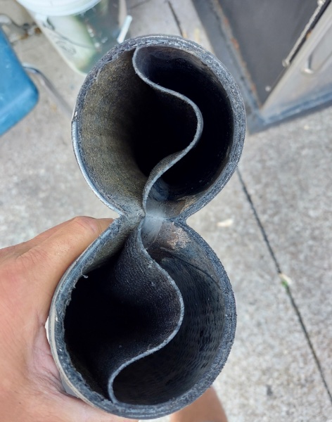

When you have tried new impeller, thermostat risers, elbows, thru hull clogged, exchanger and still can’t find the reason for the engine overheating check your hoses for a collapsed hose.
