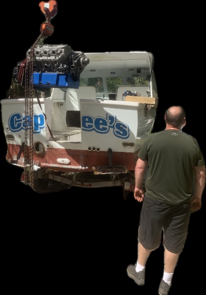

Ah I see!! Thank you for the help guys. Now I just have to finish it lol. I still have some gel coat to do in the back of the boat and finish up the engine. It’s almost ready to be dynoed. Did these boat come with a v drive? That’s how this one is set up. With a 1.5 diameter shaft. The previous owner had a 310 yanmar in it.

Not really sure if it’s feasible. but I’m shooting for a cruise speed of around 28-30

Engine pic attached

It did not come with a V-Drive. Power was most likely a Mercruiser/Ford 302 188 or 215hp or a Chrysler 318 225hp. Also the shaft size was 1" . That must have been nice with Yanmar diesel. What HP are you shooting for with the new engine? What is it, I trying to tell by the photo but my old eyes can't tell.
