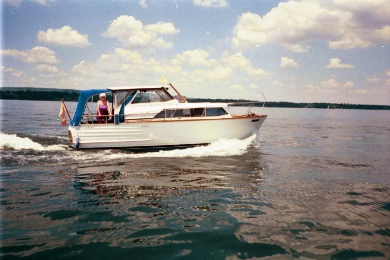

Here is a side shot of my folks setup on their old '69... you can see the enclosure runs aft from the back of the hardtop, then down. Ignore the crazy lady in the purple top (my mother... and WATCH what you say or I will hunt you down!!!).
There were side panels and an aft panel (all with eisenglass) that could be removed.
You can see the part of the frame that comes all the way down - the end of this sits in the track that I mentioned previously. Slide the base forward, and all the framing will tuck away under the aft rail. Having said that, once the cover was installed, I think it was only ever taken down twice.

Capt, your mom looks like a great lady! I think they call their type of top a "buggy" type, has same shape as my son's top on his pontoon. But I just can't picture the channel thing your talking about and how it could be made?

Posted: Thu Apr 07, 2011 12:04 pm
captainmaniac is that a Owens ?
Posted: Thu Apr 07, 2011 1:46 pm
by captainmaniac
prowlersfish wrote:captainmaniac is that a Owens ?
Blasphemer!!! And you just lost the title of "King Paul"... That is a 1969 Trojan Sea Skiff (28' version). I think the pic was taken in 1999 or 2000.
Posted: Thu Apr 07, 2011 1:51 pm
by larglo
I thought it was a Trojan because it looked a lot like the Trojan used in the Sea Hunt TV series years ago, except not having the flybridge.
