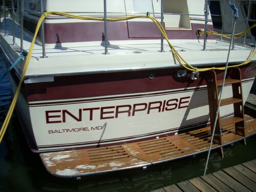

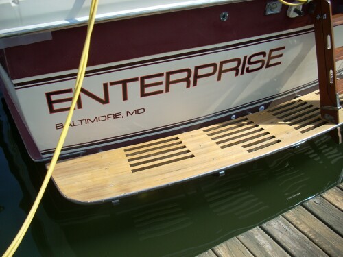

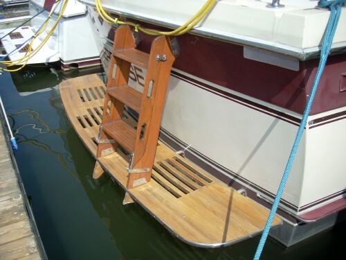

i'm including a few pics of the BEFORE and AFTER. like i said, the refinish was accomplished in about 3 days. getting the old 'non marine' varnish off was the tough part, but, once that was done, just a few days and a few hours, and, a few HOEGAARDEN WHITE ALES, and an orbital sander with 80 grit. between sandings, ran over the platform with a shop vac. the finish was very simple. a guy at trawler fest gave me a few tips. never go more than 80 grit on a platform. 100 or 120 is furniture grade, and when wet, is as slippery as dog snot. his words. if you don't want to encase it in crap, again, his words, after you get the dust off, go over it with a rag saturated in acetone. yep. acetone. he said that 3 or 4 swipes would suffice. what this does is penetrate into the wood, and, as it evaporates, it pulls the oil from deep in the wood to the surface as a protective layer. it also brings the grain up. i did this in july, and it still looks pretty good. now, the 'ladder stops' are the two small fins that are under the platform and under the ladder. you can see the one that broke off on the right of the picture. sorry if i sound incoherent. i've been flying all day (14hr duty day) and i'm wicked exhausted. early out tomorrow, one leg home, thank heaven.
BEFORE
BEFORE

AFTER, ACETONE COATED TEAK
platform redo 3 after.jpg (51.05 KiB) Viewed 9219 times
LADDER STOP 'FINS' UNDER LADDER, REFINISHED PLATFORM
platform redo.jpg (53.66 KiB) Viewed 9219 times
