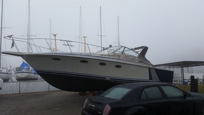

trojan resize.jpg (70.71 KiB) Viewed 18326 times
Here's a photo of her on new years eve.
