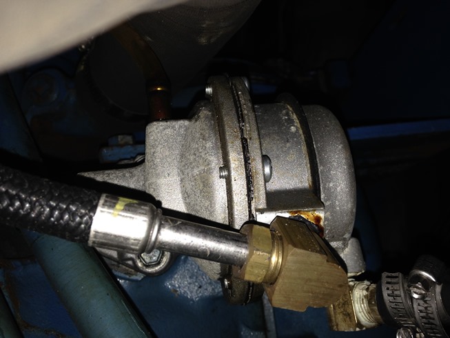

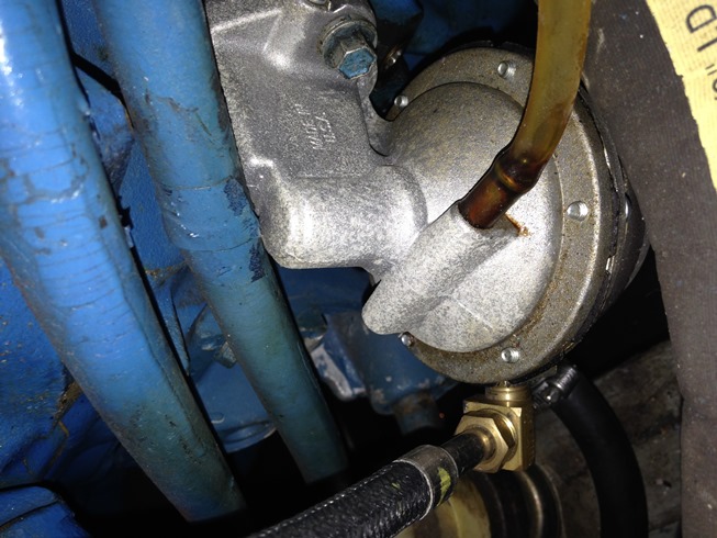

Can you post a photo of the pump and engine ? A big block Chevy pump should not be a problem . I believe the engine is newer then the boat as I don't believe Trojan offered Chevy / Crusader in 71 .( but anything is possible ) Most were Chrysler marine and some Mercruser Fords . Anyway a photo of both would be a big help .

Thanks for the reply prowlerfish. I did happen to snap some shots of the pump when I was there yesterday, but unfortunately, I didn't get photos of the engine itself. I'll have to go back for that. It was stamped with "2 GM" on the block though.

I'm pretty sure what I need is a Crusader 97843. I've confirmed these are Chevy 454's. I couldn't find it on beacon marine, but I did on these sites.
http://www.boatersplus.com/crusader-fue ... 97843.html
http://www.go2marine.com/product/153727 ... oCwhHw_wcB
- 2025 Gold Support
- Posts: 12754
Re: 71 Trojan Fuel pump replacement
They should work
