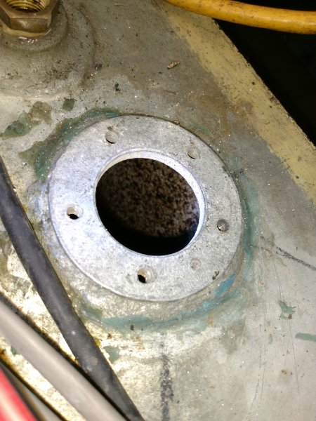

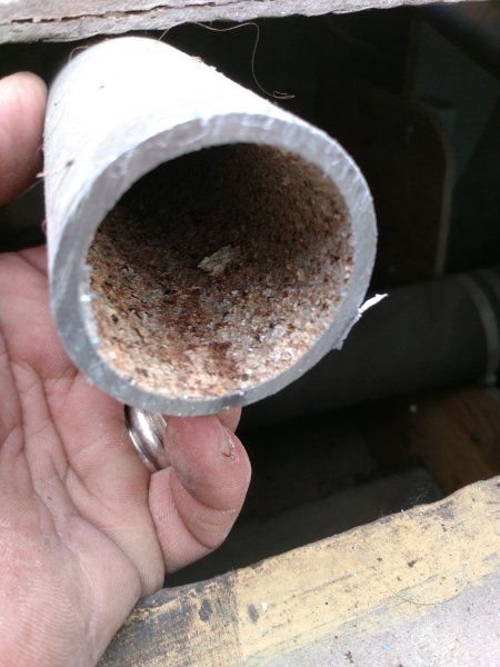

Martino
Posts: 79
Location: Detroit Michigan
Re: Help me please
Post by Martino »
This was the fuel filler neck of my starboard tank and you can see it was also inside the tank.

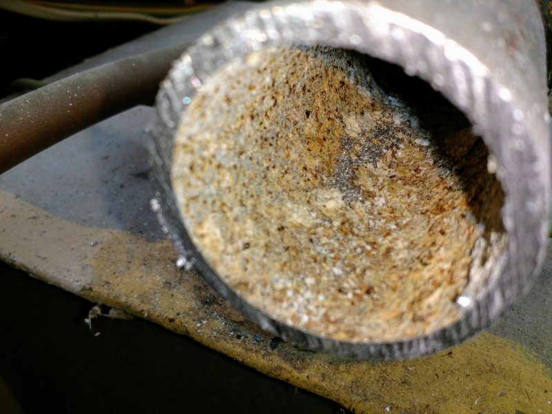

Boppy
Posts: 100
Re: Help me please
Post by Boppy »
Had same problem with my ‘77 F26 HT I bought in 1999. Original fuel tank was galvanized steel and previous owners kept on limiting the amount of gas in the tank by repeatedly only keeping the tank partially filled. Over time condensation started corrosion on the inside of the tank and that crud kept on gunking up the line. Under load like at 3000 rpm it was too much for carb to handle and result was hesitation at anything over 1500 rpm. Temporary fixes like dry gas carb cleaning etc did not fix the problem. But a new tank did! Boat has run fine for the past 18 years at all speeds.

mrweller
Posts: 6
Joined: Thu Sep 12, 2013 9:24 pm
Re: Help me please
Post by mrweller »
I second Boppy, make sure there is no galvanized steel and pull the tank clean/replace it. I fought this fight for 2 years and 2 new tanks and 2 clean tanks fixed the problem. I believe the galvanized pipe fill tube was the ground zero that started the problem. Best of luck
