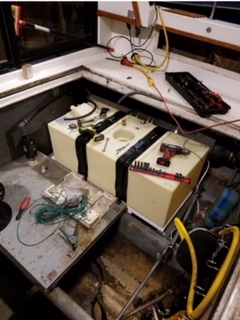

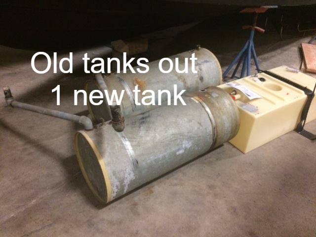

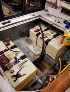

Here are some pictures and information on the installation of two Moeller 58 gal fuel tanks installed in a 1977 F-32 model 321.
Fuel Tanks are made of Polythylene
There tanks replaced the aft original galvanized round tanks.
Tanks are 44” long by 21.50” wide by 18.75” high
We have some good pricing and shipping cost on these tanks
* For a F-36 Moeller makes a 126 gal tank like the picture above.
54" Long by 32" Wide by 21.25"
** High add 2-1/8" to tank height to accommodate fill height
