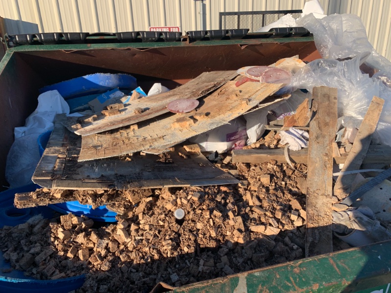

A shot of the dumpster with the guts

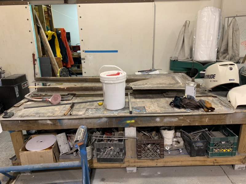

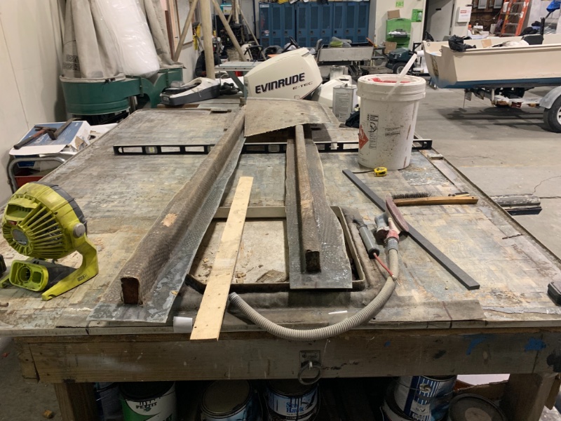

My deck on the lower cockpit was soaked with water and rotten throughout
My marina is handling this one, back is all cutout, old rot removed and sanded down
Coosa board will be used to rebuild
