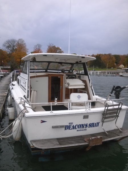

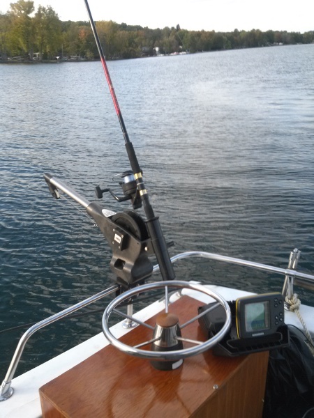

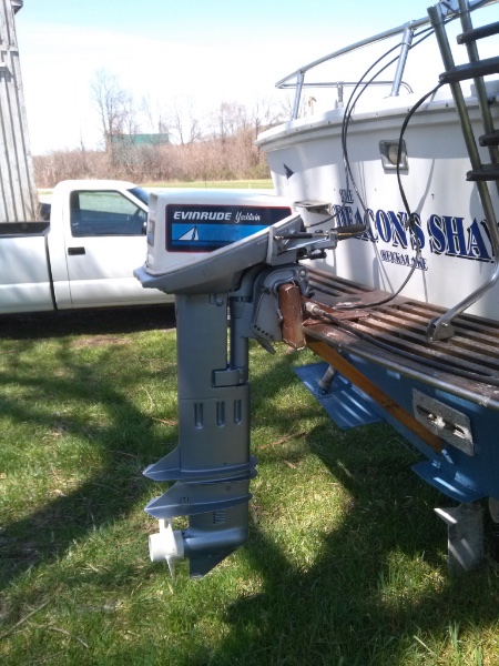

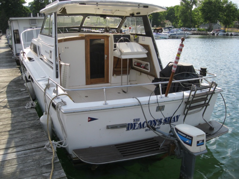

Just for grins, here's some rigging I've used for fishing (also came in handy for docking assistance when the wind wasn't favorable). There is quite a bit of room back there. For the money involved and the uncertainties about fit and function, think I would consider an electric trolling motor in some kind of configuration (obviously much less of a profile than the motor and apparatus I used). If you look closely at the second pic, you can see the waterline mark on the strut.

Oldboat1 That configuration looks like a good Plan C. Hopefully I can get one of these proper thrusters to work. If not, we'll be looking at you.
