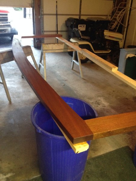

We also wanted to be able to clean fish on the boat, so made a table out of Starboard that slips on the back rail. Might be easier than trying to modify the ladder.

Did you Raise the rail ?

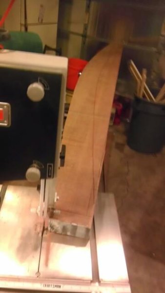

Paul - We completely scrapped the factory setup.
At times we are running 21 lines and get 3-5 people shuffling around the back deck ( double, triple, quad hookups). This one is made from 1.5" thick wall stainless and welded stainless flange. gap height is 17.5 inches.
The board was fashion from a 2" x 14" x 17' piece of Mahogany. ( I don't even want to admit what the piece of wood cost ) This allowed me to match the aft curve of the boat while having one continuous piece of wood. The p/s pieces were cut from the remnant and doweled, glued and mechanically fastened.
The whole setup is super strong and I don't worry about people as much with this setup.
Couple of pics of the build

For a 6 pack there is no rail height restrictions. Yes i am raising my rails next season. But i really need to know how you fold up your ladder . That will give me so much more room.

Nice Job on the rail
