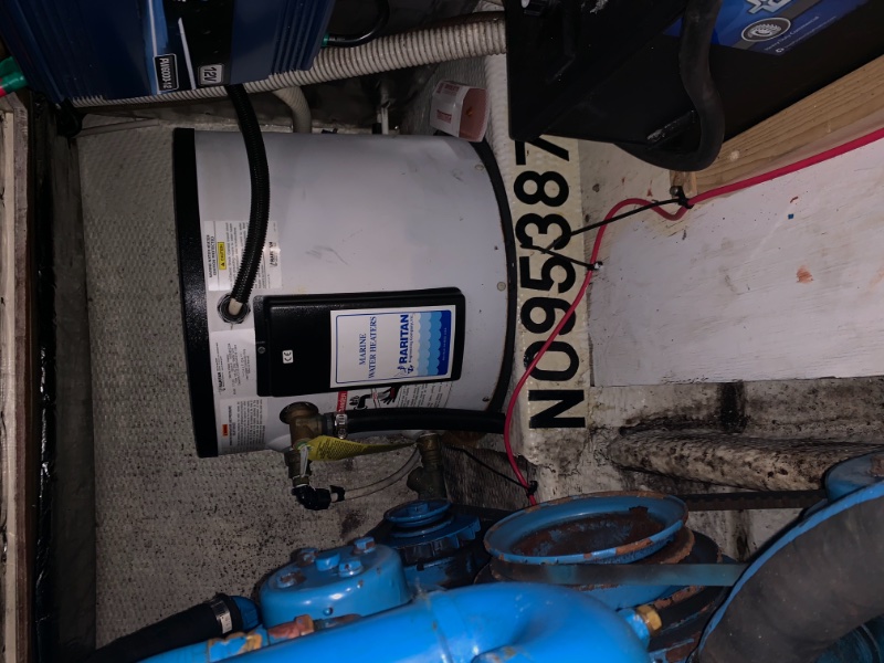

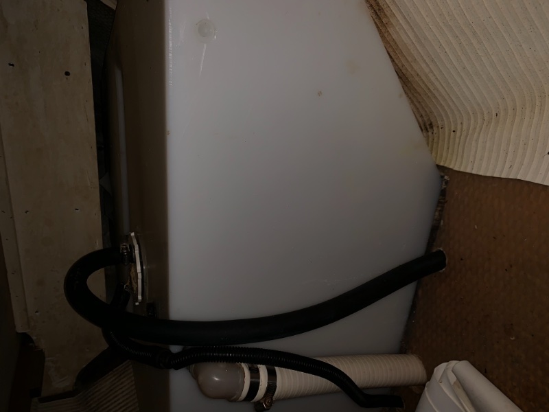

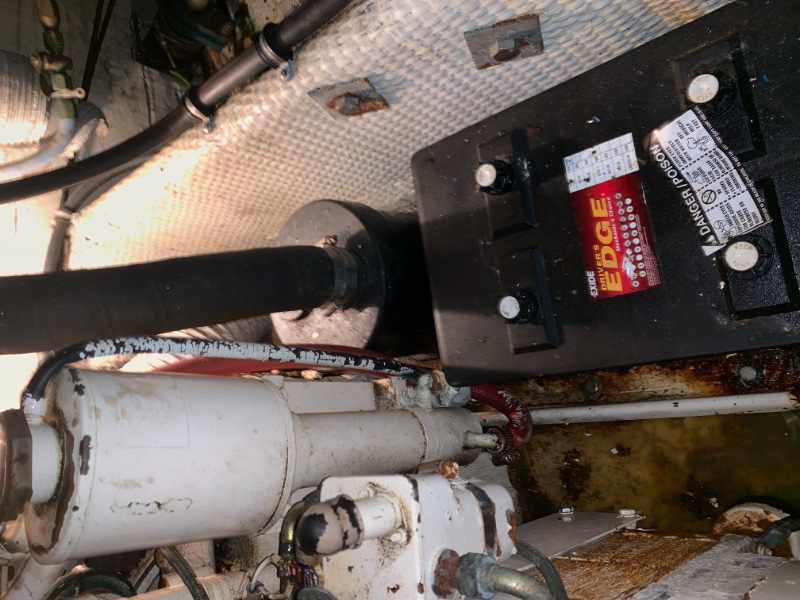

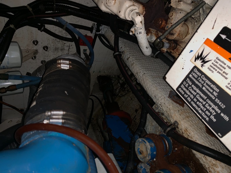

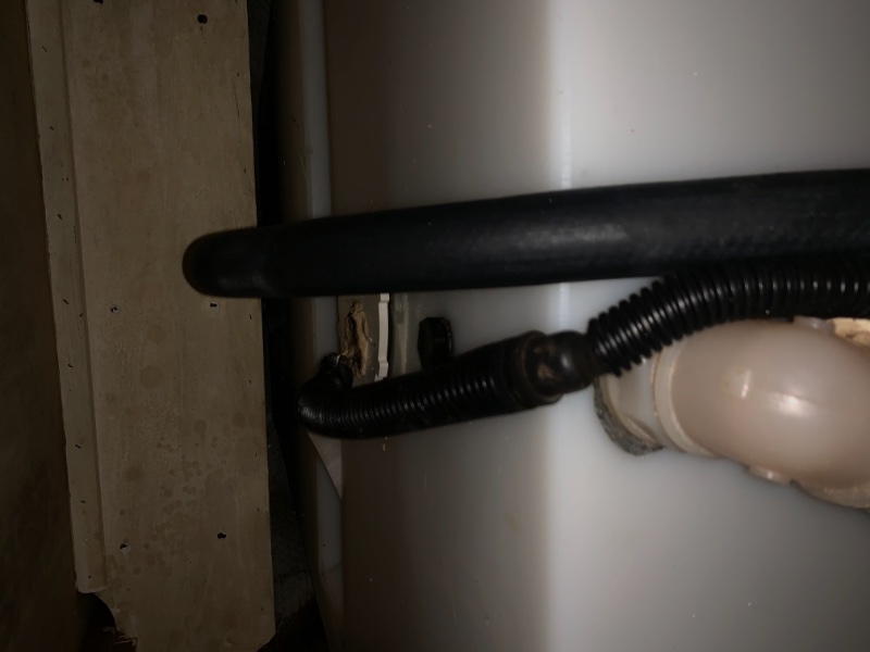

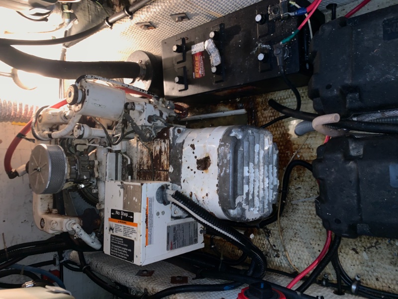

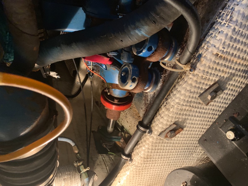

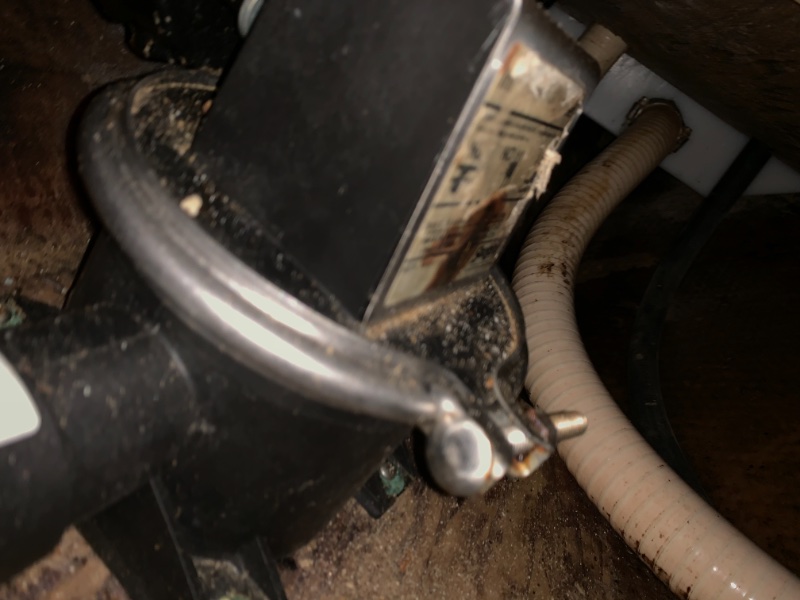

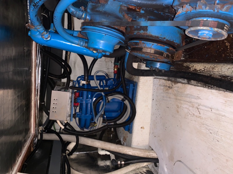

Thank you. It looks as if I have pumps in one of the two forward compartments. When I turn on F/Water P and have a freshwater hose connected, water works ok. Not great but OK. Once we turn it off, zero.
Called mechanic and he said “it’s usually the filter on pump forward getting clogged. I cleaned it. No way.
Here’s some pics. Thank you for your help!
Magnus
Magnus

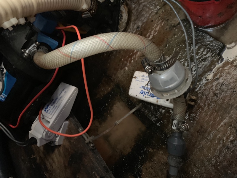

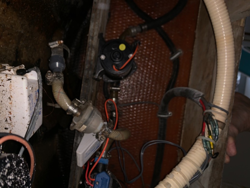

More pics. Again thanks!

I disconnected the lines one at a time on both ends of water pump while it ran. Dry. Nothing. This was after filling it up.

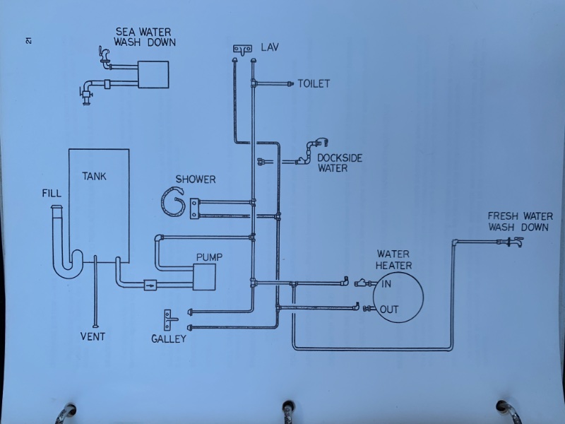

Hers what the manual says about my system.
How do I access the 55 gallon tank?
I see the forwRd plastic tank in the bow, but since the mace ration pump is next to it. I’m assuming it’s the waste tank. Frankly I’m lost.

Re: 10.8 Trojan Fresh Water Mystery
it appears to me you have a later model non-liner boat and a conventional tank.
If you fill up the tank and leave the pump turned off, and it still leaks the leak is either the tank or the hose going to the pump.
I once used food coloring to quickly locate my own leak
SAFETY NOTE:
It is my understanding that batteries in gasoline powered boats are to be secured in an enclosed space/container/box/etc
SAFETY NOTE:

Thanks RWS!
The battery boxes are plastic and secured to flooring underneath.
I found the problem. It was not a leaky tank, etc. hot water pressure valve was set in the open position so it kept venting pressure and couldn’t pump water...unless the external hose was hooked up, and even then the flow was bad.
Now all good. Pump turns and off as required if minor pressure drop or use. Very glad for the help from the forum!
- P-Dogg
- Posts: 965
And you'll want to do something about the two loose wires encumbering the bilge pump float switch.
Glad your mystery is solved.
