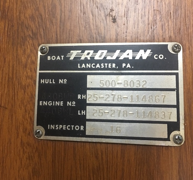

Look for you Hull Number

I need to find that tag, title says 3122093.
