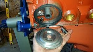

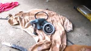

If its not the filter ,It also Could be the seal under the oil filter adapter . 2 types used. But hopefully a bad filter make sure the old filter seal came off
- oil filter addat.jpg (13.68 KiB) Viewed 9943 times
- oil filter.jpg (13.21 KiB) Viewed 9943 times

I changed the oil and filter today. When I started the engine up oil was leaking from where the oil filter adapter meets the engine block. Can I just replace the gasket or do I need a new oil filter adapter. The type I have is the one on top in prowlersfish post with the 90 degree turn to it. Also, is there an instruction sheet somewhere that shows how to replace the gasket/adapter?prowlersfish wrote: ↑Sun Jul 14, 2019 6:56 pm If its not the filter ,It also Could be the seal under the oil filter adapter . 2 types used. But hopefully a bad filter make sure the old filter seal came off

Looks like it . Pretty simple to replace , hard part is the cleaning the gasket/seal area . one large "bolt" replace the seals on the bolt . Make sure its all lined up to were it was .
