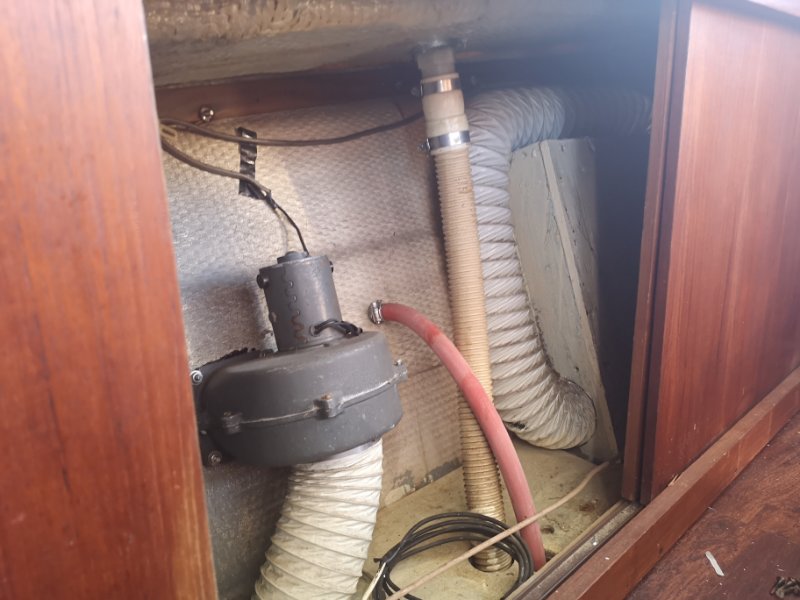

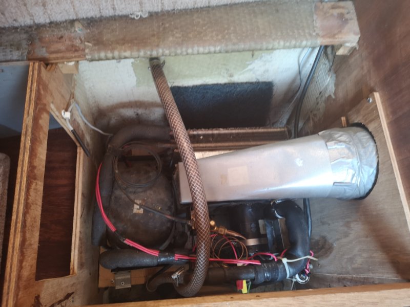

prowlersfish wrote: Sun Jul 28, 2019 12:44 pm That is were a engine room vent/blower should be . Its much larger so it likely still has that behind it and maybe a added vent for something else ? It would be interesting to see what's there .
I tried to look in to this yesterday but it ended up being built in to a box, in the storage walls in the salon. The box was fastened with a straight screwdriver, which I left in my car :roll: Is it supposed to be boxed up from the inside? The hoses (if that's what they are called) are really dirty, and torn in several places. Adding that to my list of things. They do run from under the engines, and from the A/C unit on the other side. So it seems that might be what is going on there. Will take pictures when I get it opened up.

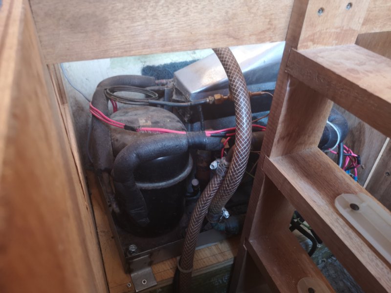

Post a photo of the AC too , if you can

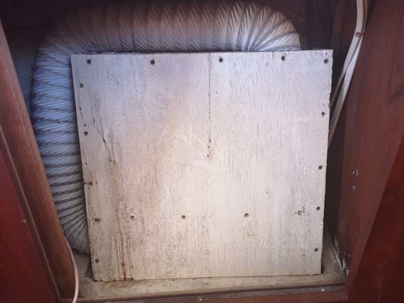

The box is siliconed in tight. I'll have to bribe some muscle to get at it.
The infamous box
The infamous box
The other stuff
The other stuff

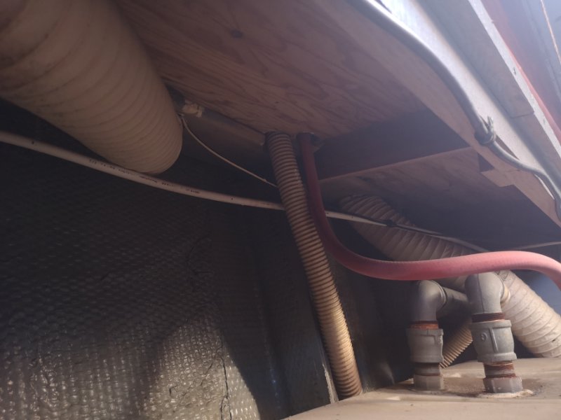

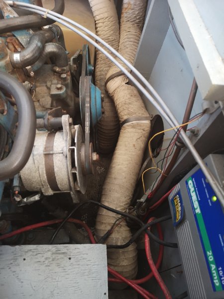

I may have been mistaken/misinformed about the AC meeting up in here. Seems the two hoses I was following don't actually connect behind the stairs.
Starboard side
Starboard side
Port side
Port side
Under the box
Under the box
The A/C is much easier to get at.
AC unit
AC unit
From the top
From the top
- Mia

I agree I don't think that vent has anything to do with the AC. The box inside is likely put there by Trojan . the hose from the side that loops to the top is odd . Any one else have that ?
Re: 1975 F32 Trojan Endless Love <3

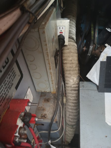

That pic with the 120 volt duplex receptacle isnt in the engine room of a gasoline powered boat, is it?
The wooden box on the port side encloses the forward vent that is on all the f32 models, someone has changed the outside appearance with the big box louvers.Imo, doesn't look very safe to me. This could be the which way should the vent louvers face ??? :P
The big hose is going down to the engine compartment.That is my take on it.

P-Dogg wrote: Fri Aug 02, 2019 6:58 pm That pic with the 120 volt duplex receptacle isnt in the engine room of a gasoline powered boat, is it?
Yes, it is... is that bad? Should I be moving that? Surveyor didn't bat an eye at it :(
It's about 8 inches from the starboard engine.
- Mia
1975 F32 Flybridge Sedan
We had a similar outlet in our engine room. The surveyor put it in the must repair category so I just removed it and hardwired a new battery charger.
I suspect the electrical panel with breaker is also not ignition protected.
